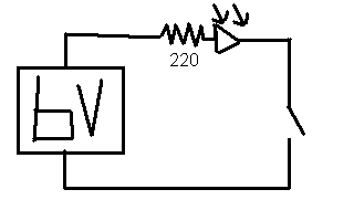

Will this work then?

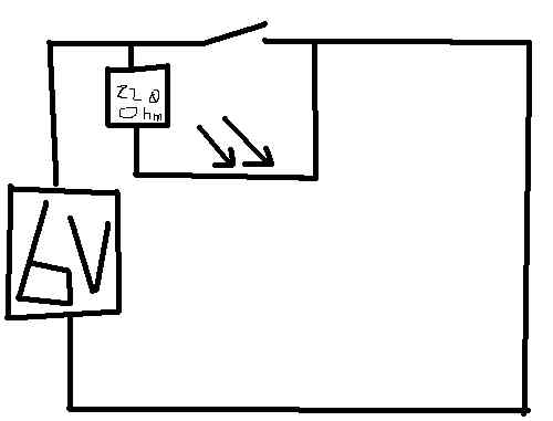

I made a quick circuit... will this work (srry for bad english)
Nope, the LED would always be on and the switch would short out the battery. Attach the resistor inline with the LED and the switch inline with the LED to the battery.
I love mspaint <sarcasim>

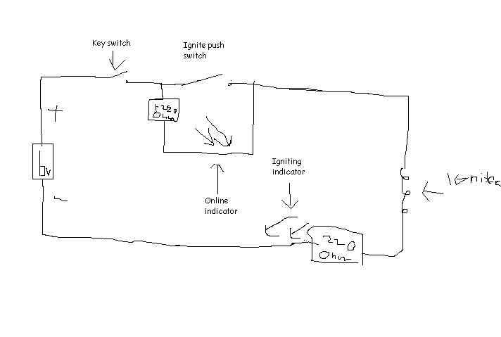

Look, the LED (in my sheme) is an indicator that the sys is online (after battery there will be a switch so i dont burn all the time). There for i need the resistor. If i press th press switch above my LED, there will go 6 volts to a glowing wire, so it can ignigt a fuse. This is for an huge fireworks show at the 31 December at my school (yeah they got a licence). I was pointed to make an ignition system. please help guys, the ignigters are done, now onley the cirquit!!!
I will make a betteer sheme of the idea now

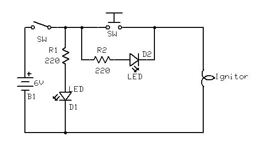

fighterdion,
If I read your circuit right, the one with two switches, you want a "system on" switch and indicator...also a "detonator switch" with an LED to indicate that the igniter circuit is connected. The attached circuit should do that. R1/D1 indicate power is applied to the system. R2/D2 indicate a complete circuit through the igniter. The pushbutton switch bypasses R2/D2 and provides full current the the igniter when pushed. Are you going to have multiple ignition pushbuttons?
Ken

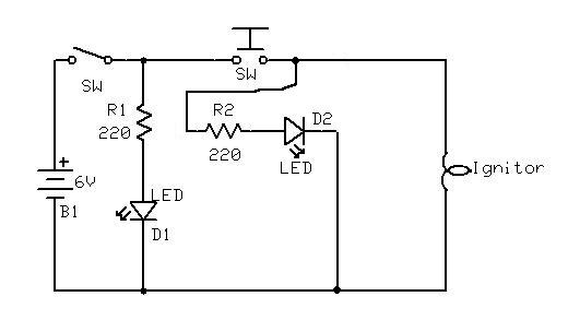

Won't that run power through the ignitor as soon as the system on switch is closed? I should think the circuit you would want for adding an LED to indicate ignitor activity would look something more like the attached (forgive my mspainting of your scheme)

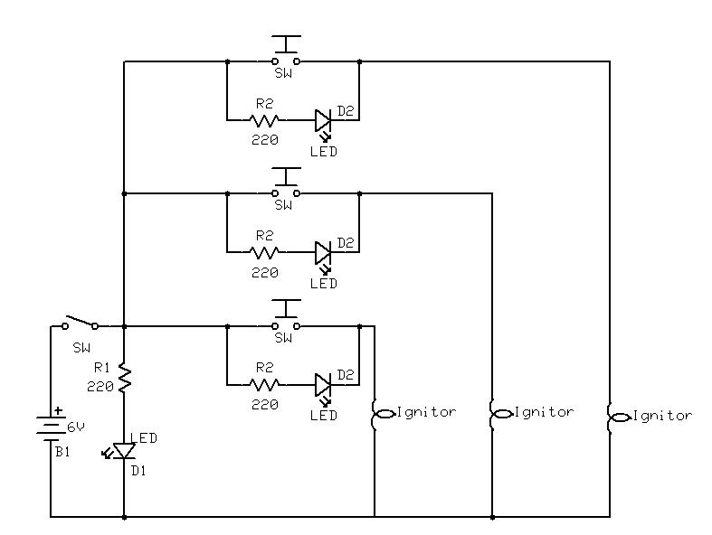

Yes, i want to make multiple ignigte buttons (about 5 - 10)
fighterdion said:
ty! that was what i where looking for! +rep
If you had explained exactly what you wanted to do in the first place, it would have been easier for others to help you. All you said originally was that you wanted to light an LED, and you required the appropriate resistor value. There was no mention of creating an ignition system, and hence Sceadwian was not able to offer you advice in that regard!

Attached is a circuit for 3 buttons/3 igniters. You can see what I duplicated for each additional button/igniter.
Darth,
The resistor (R2) and LED (D2) limit the current through the igniter so enough current passes to light the LED, indicating a complete circuit, but not flash the igniter. Once the pushbutton is pressed, these are shorted out and full current is supplied to the igniter.
I think the 220 ohm resistor (D2) is probably high enough to provide a safe current, but this is a guess. 1000 ohm resistors for D2 would be even safer, but with some reduction in LED brightness.
Also, from the information so far in this thread, I'm not sure attempting to create control circuits for explosive devices is a good idea with the level of understanding of basic electronics shown. I hope there's someone knowledgeable on-site that can check your work. I've been in hobby/medical/scientific electronics for about 50 years, and I would be very reluctant to want stake other's safety on what's been shown. I've built enough circuits over this period to know errors can be made even in the simplest of circuit assemblies...especially if one doesn't know why a circuit is designed the way it is.
Just a strong caveat!
Ken
