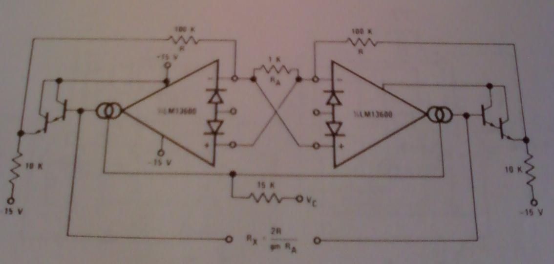

It's not a switched capacitor design but I ran across a reference design in "The Giant Handbook of Electronic Circuits" It's an old design but it includes all component values except the darlington pairs, I'm guessing with a modern opamp you may not need them depending on your requirements.\
Sorry about the bad picture, it's just a quick cell phone grab. Should be enough to get the jistt of it.
I take that back, I guess the darlington pair is integral to the LM13600. It looks incredibly simple t o construct.
