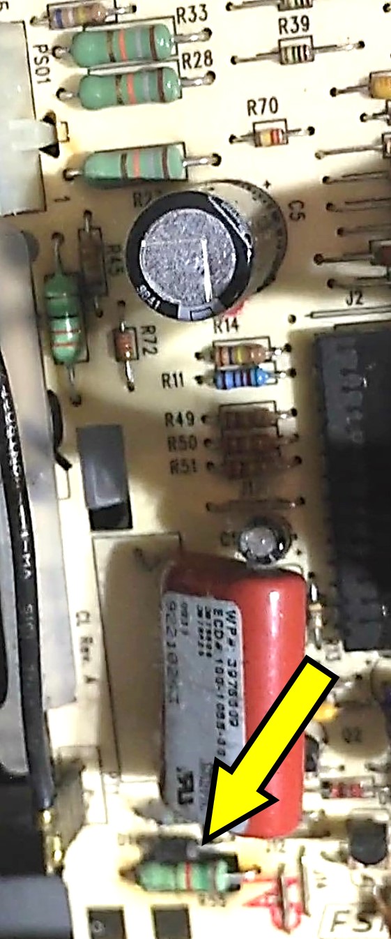

Unsure of this resistor type. From a Kenmore dryer. Any help would be appreciated. Thanks

Probably a small wire-wound power resistor. Depending on the size of the diode near it (for scale), 1 to 3 watts.
ak
It could be an axial inductor rather than a resistor, they often have green coated bodies; 88mH 20% if it is and I'm reading it right??
That would be a rather high value for an axial style like that - but equally, an 880,000 Ohms power resistor seems very unlikely.
It could be a custom fusible resistor marked with an ID number rather than value, I suppose/
Looks very old and looks like it's run very hot. If it's 880k as indicated then I'd guess it's in a high voltage part of the circuit. More information would help. Sourounding parts, scale etc,
With time / temperature color-shifted bands, it could be 1.1, 2.2, or 3.3 ohms, all standard values.

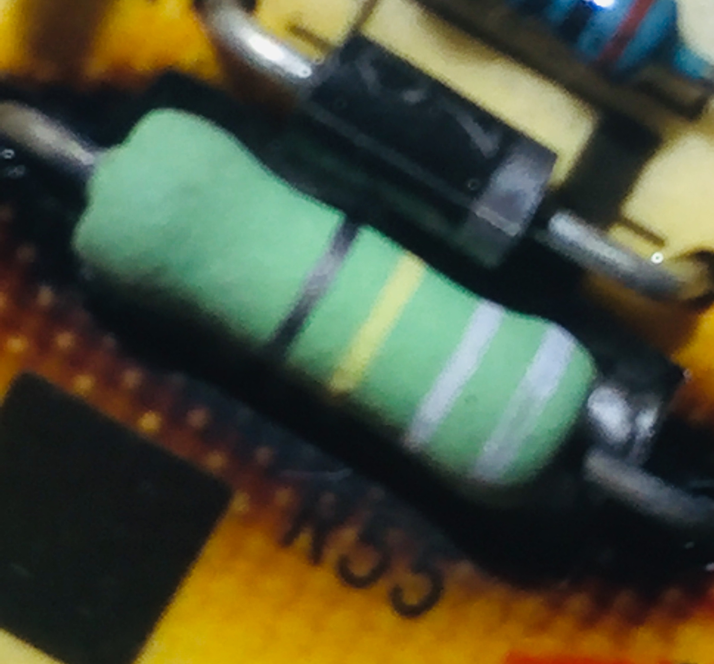

Thanks all for your input. I've added a second pic taken prior to the resistor failure. The color bands appear to have changed die to the failure. I just can't make out the colors to determine type.
