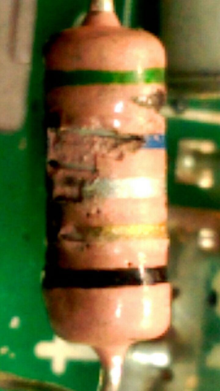

Hi guys,
what is the value of this resistor? Is it 0,56 ohm 5%?
Colour: Green, blue, silver, gold, black
Thanks, you are always helping me!!!
It´s on a treadmill controller, switching power supply side.
Third band is tolerance, 5%. Fourth band is temperature coefficient.
