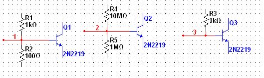

how do i know which one of these configurations should i use when controlling a transistor?
IF the transistor is a BJT that means that its voltage controlled and circuit A + B would react the same since current, not voltage is reduced?

A BJT transistor is controlled with current, not voltage.
A Fet transistor is controlled with voltage.
None of your circuits make sense because they need a regulated power supply and the voltage is not shown for us to calculate currents.
oh, k , got them bkwards! , Please feel free to use any voltage source, or any gain level for the transistors, or modify the resistors as you see fit, im just trying to figure out a general method for my switching apps, i just dont get why(or when) you would use resistors at all, since all the power u need to switch should just come off an input line,no?
No. Read **broken link removed**. Then get back to us if you have any further questions.
The tutorial is WRONG.
Beta or hFE is used only in a linear amplifying transistor that has plenty of collector to emitter voltage. A saturated transistor has a very low collector to emitter voltage so beta or Hfe is not used to calculate base current. Instead, the datasheets for most little transistors show a base current that is 1/10th the collector current.
The concern about using the input line to switch the transistor is that a bjt has no limit on the amount of current it will allow to go into the base connection...even if it causes smoke. If the input signal is capable of supplying too much current, you must limit the current with a resistor.
