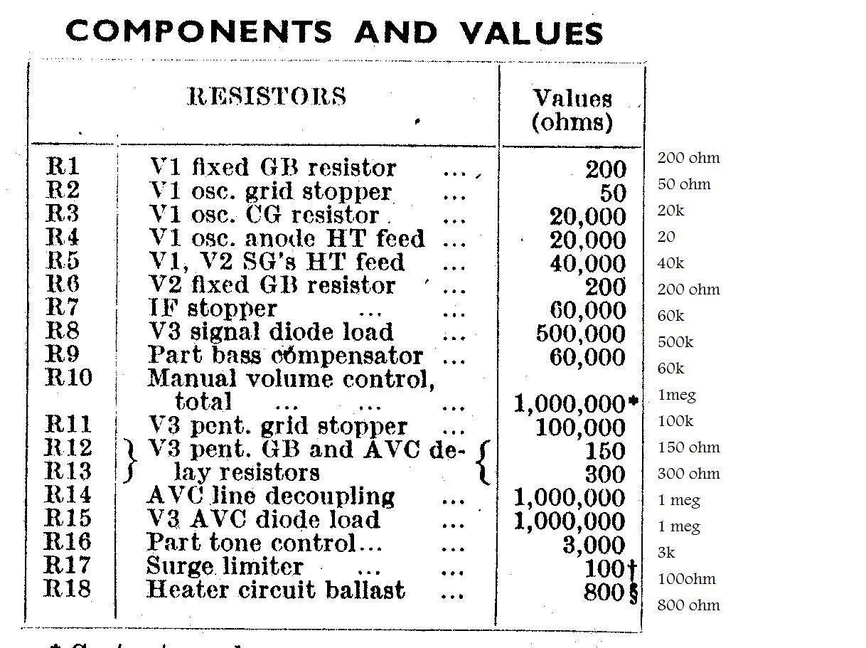

hi all I'm restoring an old valve radio
i have got hold of the schematic of it but just to make sure i want to replace all the resistors
i have put a photo of the original resistor list just want some one to check see if i have them correct
thanks

Something I notice from that list, many of the values are not modern "preferred values", so it may be necessary to substitute the nearest preferred value.
Before embarking on a wholesale replacement, it is well worth checking the values of the existing resistors.
My best guess is that lower value resistors (less than 1k Ohm) will be well within tolerance (+/- 20%),
higher value resistors (greater than 10k Ohm) will have drifted high in value),
wirewound resistors will either be the same value as the day they were made, or have gone open circuit.
The resistors are probably OK. I would worry about the capacitors first, and most of them are OK.

The only real troublesome ones are the bumblebee caps and the electrolytics. Be careful what you change in the tuned circuits.
The service manuals usually have resistances that can be measured "in-circuit" from various points.
I don't know how old the radio is, but watch out for resistance line cords. They had Resistance on purpose.
Variac's are always useful. Especially if you can monitor the voltages across the caps.

resistors seldom cause problems, ones 100k and over can sometimes go high in value.
Power supply electrolytics are a problem and either go short or leaky (both electrically and the sticky goo).
Make a test jig that puts a 60w light bulb in series with the mains live for initial testing.
Also take care if the set has a plug in mains lead, these often do not have a polarising pin, and one way round the chassis will be live.
