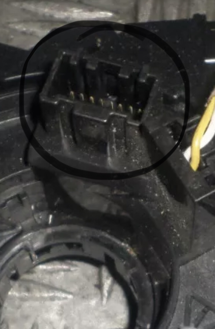

Thanks guys for your responses

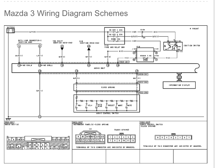

I thought the connections on the photo were for the airbag and horn and the 8-9 pin connector was for the buttons as in this photo. If so that would make it much simpler.
What do you think?

Sorry, I missed that in the pictures. For the F150, I had the manuals and didn't need to rely just on pictures.
Do you have the wiring diagram for that clockspring?
I wonder if it's a coincidence that a 5x4 matrix requires 9 connections?

Thanks for that diagram. It has similarities to the Ford. Namely, it uses a resistor string to "code" several switches with just 2 wires. But given the number of contacts in the connectors, that approach may not be necessary.
One reason I end up buying manuals for my cars is that electrical diagrams I find on the internet frequently are almost impossible to read. Your Mazda one is no exception. Is the link more legible?
It looks like the 6 audio control switches produce a voltage on pins 3(?) and 4 that is proportional to which switch is pressed. It's what is connected to the other pins that I can't decipher. It is possible not all positions are filled.

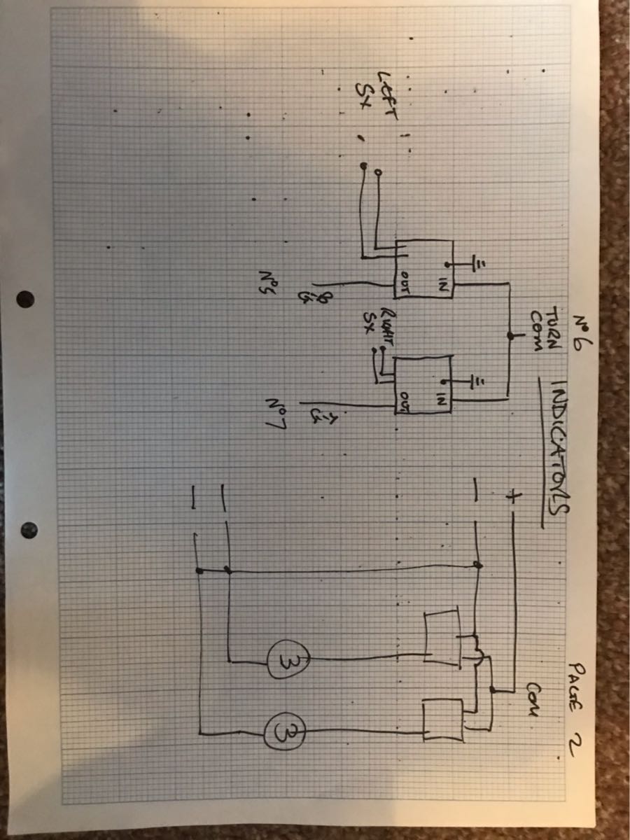

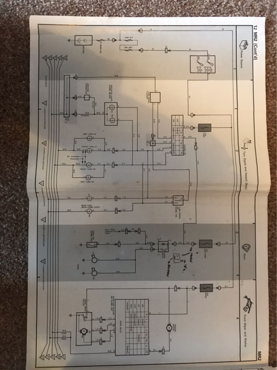

Hi all
Only a year but I have managed to accomplish what I set out to do and fitted the buttons, rotary switches etc to my steering wheel but I do have a couple of issues upon testing hence my plea for help again.

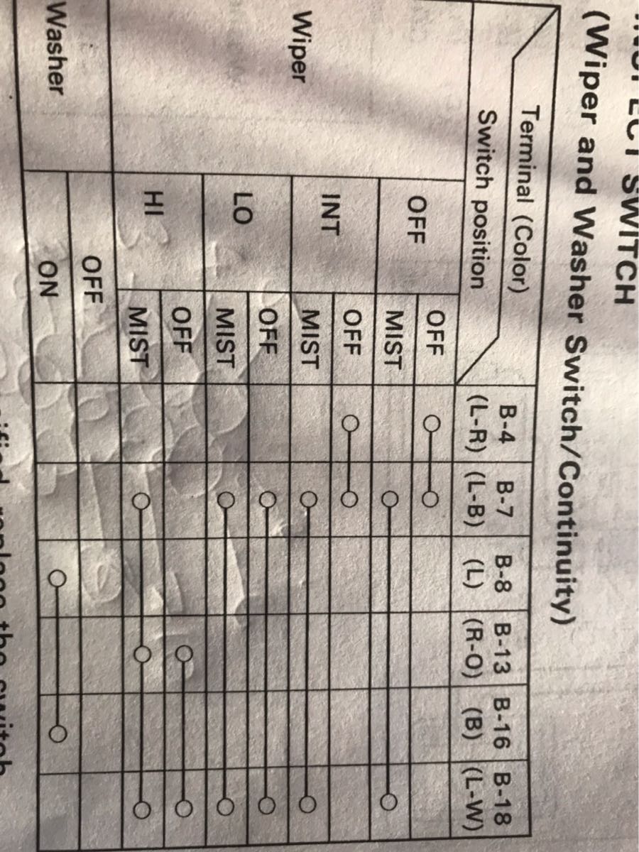

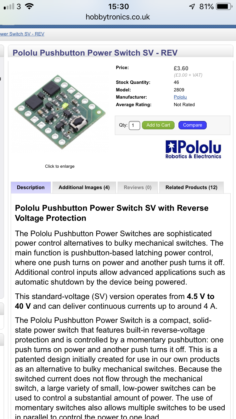

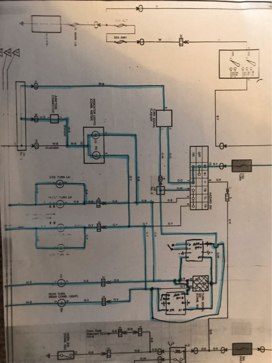

I used 2 Pololu Pushbutton Power Switches to initiate the turn signals but upon fitting the wheel to my Toyota mr2 mk2 I only get a click and no flasher. Real head scratcher.

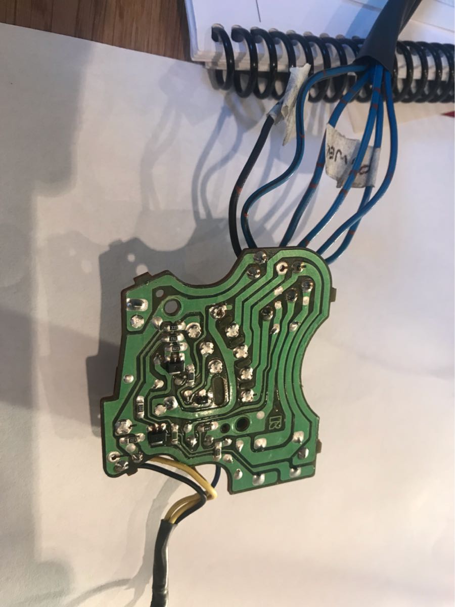

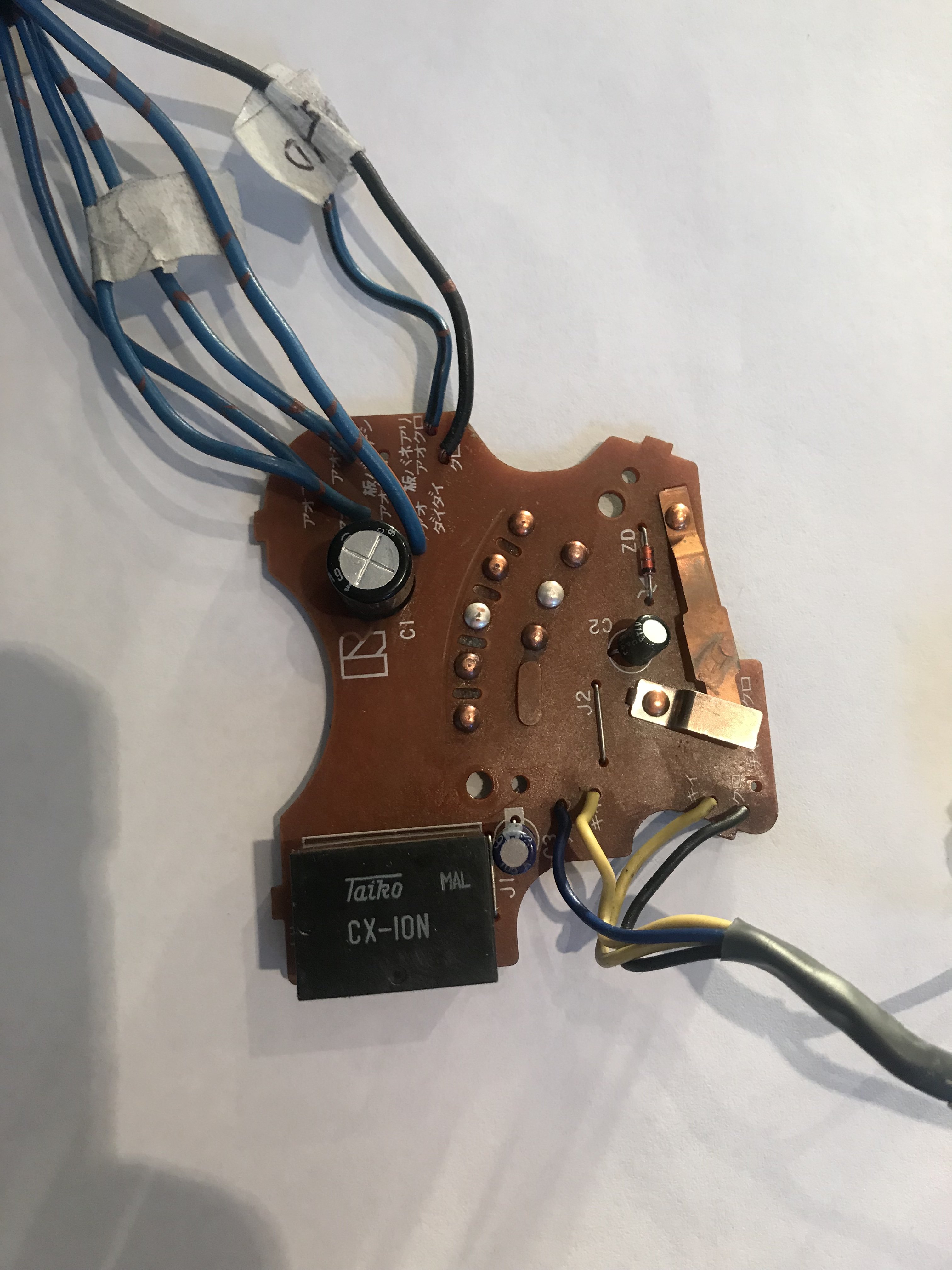

Also utilised the wiper circuit board and modified it. But again on fit I have an issue. The wiper when selected is laboured and grinds to a halt when fast speed selected.
The pololu switch diagram is readily available on line and I will attach a couple of picks of the wiper circuit.
Thanks in advance of any help.
Regards
Dave

First pic is a screen shot of website
Second is how I wired them in
Third is wiper module. I connected all the contacts to a rotory switch
Forth schematic of indicator switches
And lastly pic of wiring diagram for indicators and wash/wipe
As per the blurb, the switches don't retain their state when the power input disappears and they usually power up in the 'off' state; so every flash would turn them off when wired as shown.
To do what?
