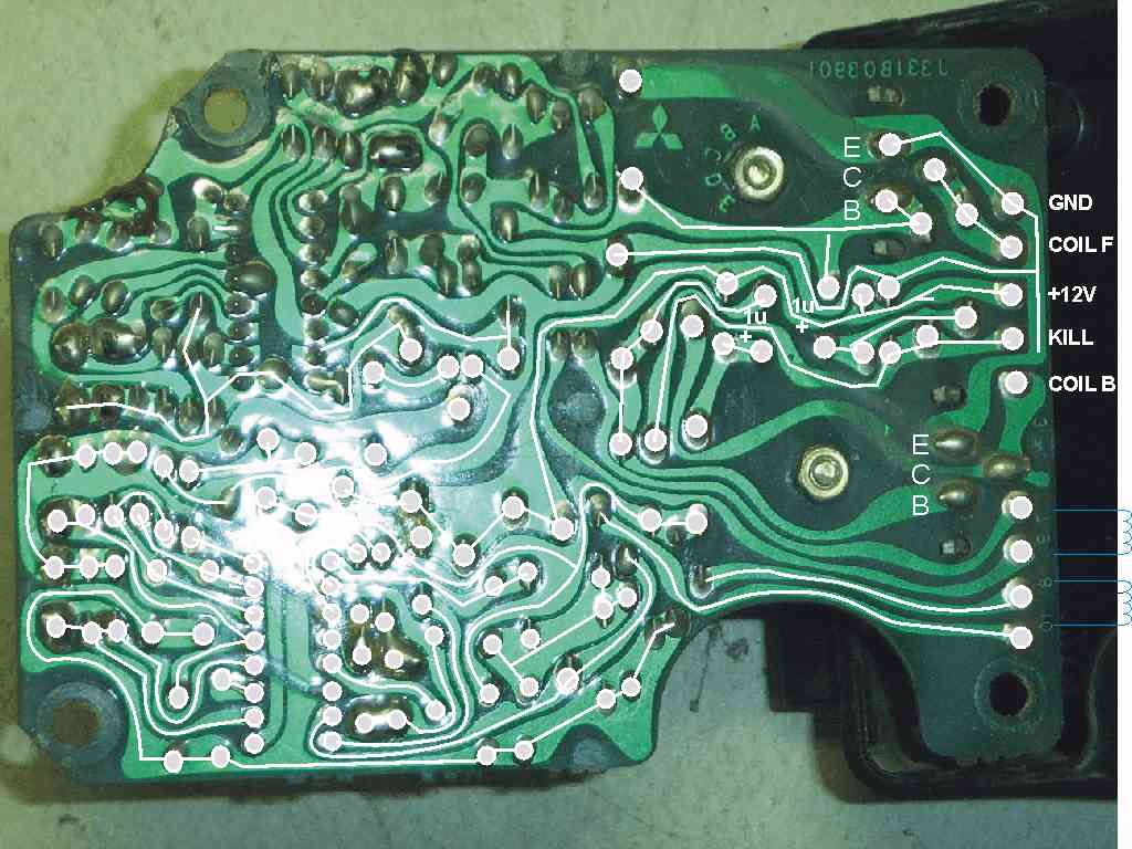

Something that works for me with simple boards is to take well aligned photos or scans (depending on the height of components).
I scale the 2 photos as objects in Corel draw & set them to lock.
Then trace over the tracks, .then add the pads
Any tracks that are the same Copper are grouped to aid netlist creation.
Flip the tracing to the component side & add in the parts.
In corel draw the parts are objects so only need to draw them once & then past... its actually quite fast.
Now the circuit can be analysed much easier than turning over the board to look at the other side & making mistakes trying to visualise & remember the previous side.
Should be able to do the same with a PCB cad program if it can import a photo could import a photo, one could trace this with tracks, place pads & components then generate a netlist to import into schematic capture.
example tracing XV TCI.gif...

I've done something like this in the past. I use two ideas...
One is to scan the bottom of the board with a regular scanner.
The second is to shine a flashlight on one side of the board while
looking on the other, but this only helps when the board is translucent.
It does take hours though. A little driver board i did once just to understand
it (not really because i wanted to service it) took about two or three hours.
Taking a scan of the top where the components are helps a little, and then look
at the board and fill in the top traces manually in a good paint program. Still
not easy though.
