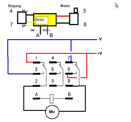

This is what I have from Mat-Con, can you correct numbers and letters to your wiring?
Thanks for quick response!

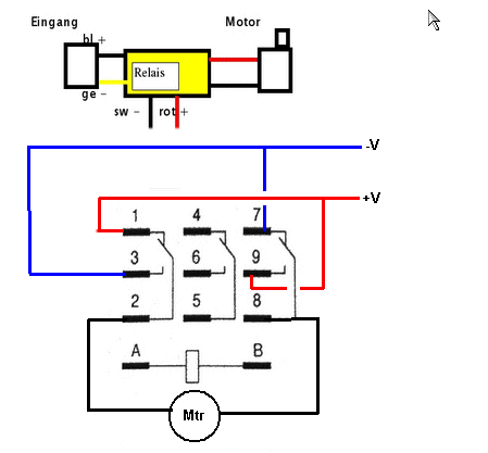

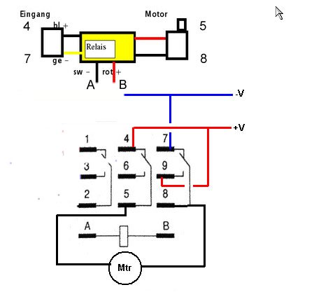

hi
Just move the two left wires to the centre pins, refer this image.
