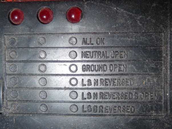

Days back, electricity wiring (that came from a transformer and that) which connects to our building was cut under the road. There was some work that going on, the water supply board was carrying it. They dug the road, and cut-off the wiring of our building. Now, they have connected a temporary wire that takes an aerial route. They have interchanged phase and neutral. I found using this: LED's that describe the condition/state of wiring, in spike busters. [Attachment] That works pretty well, it is just arrangement of wires inside, with no any electronic chip.
I think we need to have some discussion on it's working.

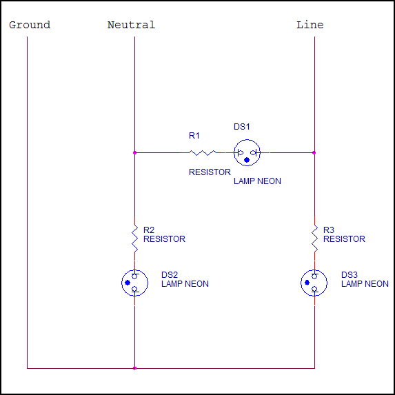

OK there Electroenthusiast attached is the general design of a basic AC line voltage tester for single phase AC as it would come into a home or residence. Remember that Ground and Neutral should be tied together at the source. Look at the image and tell me how it works. :)
Ron
;) Thanks Ron, that image tell's it all. But the have used a simple LED here, in my spike buster.
Source/Drain/Gate of FETs, if i'm right?? I'm gonna work on it and will be back.
Yes, many "spike busters", surge protectors or whatever you choose to call then use a single LED. They basically come down to one of the three version I posted. The idea is to look at the circuit I posted and figure out which lamps illuminate under which conditions. :)

Okay Ron, I'll figure that out. But, what seems to me is: LED's glow only when excited from one side. Need to use a Dual sided LED for this. To confirm, whats abbreviation of DS1,DS2,DS3.

In the three light example of an AC line tester I used Neon lamps with series resistors. Attached is an image of a basic typical neon lamp. The lamps have two elements and will fire or glow on AC or DC. When DC is applied only the Negative element will glow. When AC is applied both elements alternate glowing so both look to be illuminated. Lamps like this were used in AC line testers long before the LED was ever around. :)
Think of them as a small incandescent lamp as far as a voltage detector goes.

Nice Ron, I understood that. But, what if i need to use a LED in the place of Neon Lamps?
Image **broken link removed** shows the symbol for Neon Lamp, but what symbol is that (in your image) for?[so that i can know]
The symbol I used was from an Orcad library as I happen to have done the drawing using Orcad Capture. I just used the part as was without editing it or making a fresh part for the library. Actually if you Google Neon Lamp Symbol you will see a few variations, the one you posted being pretty common.
As to using LEDs? I have seen a few circuit testers that actually incorporate small transformers but for the better part units like this are permanent fixtures in line systems. LEDs can be mains powered with a little effort, I suggest you read this link and search these forums as the question of mains powered LEDs comes up quite often around here. Given a choice I would use neon lamps like NE2 if I were to build a line tester simply because neon bulbs, like LEDs last a very long time. Each branch only requires a NE2 bulb and resistor therefore very inexpensive and easy to build.
Ron
