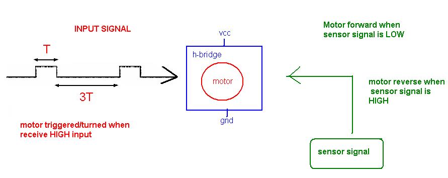

Anyone have any idea on how can i make this possible? For example a 2 wheeled robot bumped to a wall, then after few second it will start reversing.
Can anyone give me some idea how can i start to do this? Thanx!

I also thought about the 'overload' current. When the robot hit something, the motor will draw more current. I thought i can use this to make as a signal. But is there any comparator for current? Pity me now i only know how to use voltage as signal, i can use inverter for example.
not sure this is right, as im an 'experamentalist' when it comes to electronics, but i would assume that youd run the current to the motor thru a shunt, then measure the voltage drop accross it. but as i know many people on here know the theory inside and out, im sure someone could elaborate.
I have decided to use a switch to trigger an external signal.
How to design, so that the motor will reverse when received HIGH INPUT from the oscillation? I have a reason why the T_LOW must be longer than T_HIGH.
The problem with my design now is, the current_a period is too long. I want the current_a period to be the same as current_b
