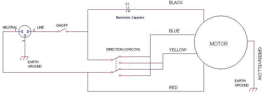

What kind of AC motor is it? Do you have the specs. If it is a split-cap AC motor (one that uses an external capacitor to generate the leading/lagging phase angle), you can easily change the direction by changing the wiring (see schematic). Check out the manufacturer's datasheet for wire diagrams and what value the capacitor should be.
