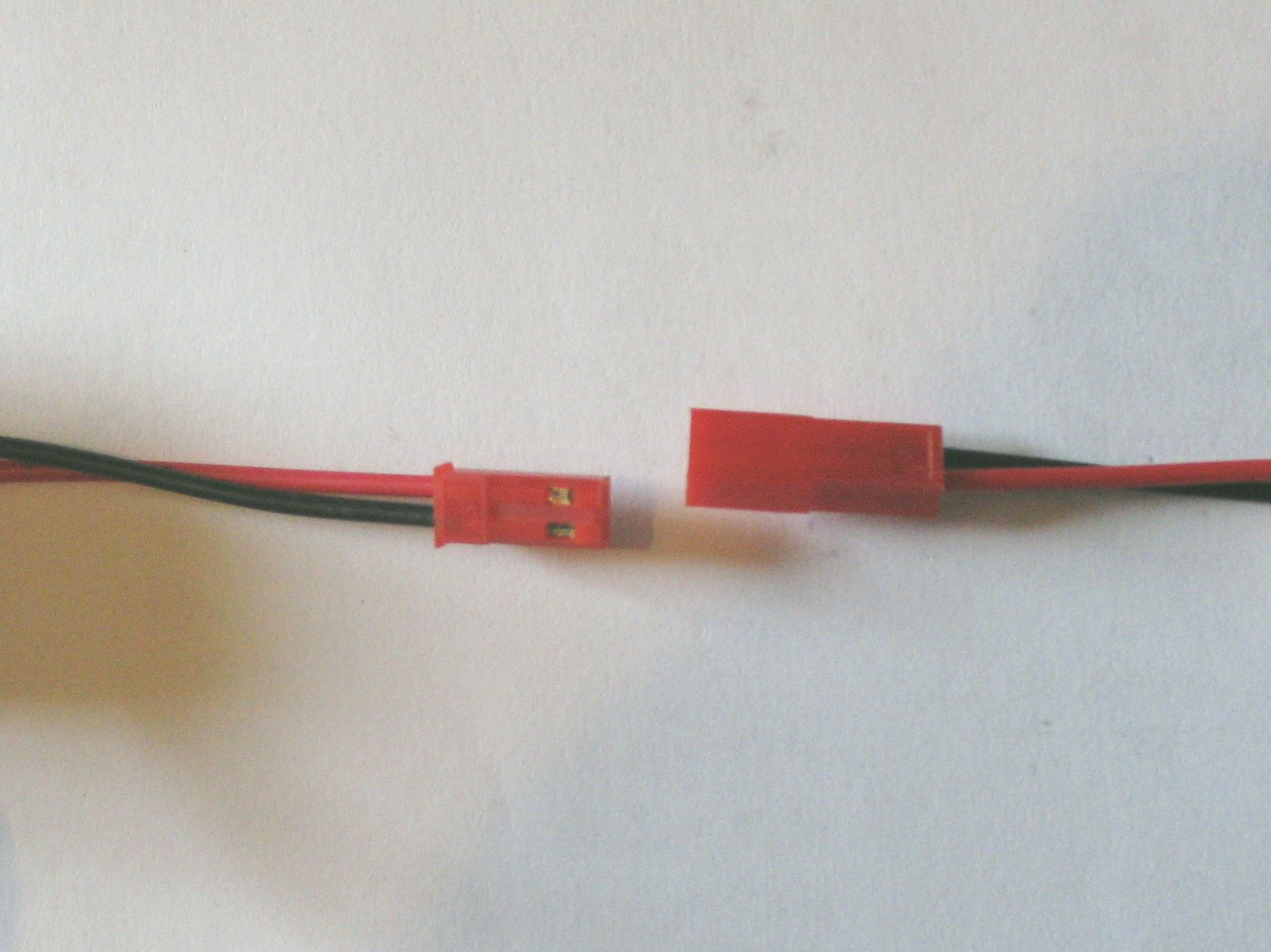

I use these plugs/sockets see attached:
After buying some more I find the polarity has changed.
I can easily change the ones on the left of the photo (I call these sockets), but I haven't been able to change the plugs. Is there a way?
Camerart.

There will be some kind of latch holding the pins in place, you need to find a way of holding the latch out of the way whilst pulling the pin out. There 'may' be a special tool available to do this, or you may have to manufacture something to try and do it - or there may be no room to do it at all?.

As per Nigel, The small window with the brass latch just needs to be pushed down while pulling on the wire.

If you bend out the pointy bit off a medium sized safety pin you may be able to puncture the plastic socket body above the tab that retains the contacts. Heating the pin may help.
Then push the pin in a bit further to depress the contact retaining tab and by pulling on the connecting wire the contact should just slide out- hopefully.:D

I'm ok with the ones with windows, it's the others that are the problem, thanks.

I have made up cables using the same looking connector and had to change the connections at times, and it has always been a simple pressure on the brass latch, that is why it is exposed, and what retains them in the first place.

There is a special size, slit-straw shaped TOOL to insert over the wire and expand the red plastic tab to unhook the metal crimp , gently, so the wire can be pulled out , without damage.
You might break it , but you can try a small knife to pry up the red plastic 1mm max in the square slot then gently tugging on the wire, it will unhook.
For the ones without windows you need an extraction tool designed for that particular contact. Usually it is a tube whose inside diameter exactly matches the outside diameter of the contact. The contact has one or two tines, and the tube slides down over the contact, down to the tines and compresses them back into the body of the contact so it can be removed. Molex has app notes on how to extract pins.

Is there a convention for which way round they are? I have a LI-ON battery with expose pins towards me and the wires going down, the RED wire is on the right, but I have lots of them the other way around.

I've just tried pushing a thin piece of plastic down to hole, but it didn't work. Next I cut open one of them and pushed the 'ratchet' down, but it can't be done so that it springs back. (Probably my cheap ones) so they would need to be bent back, before re-fitting. (Not easy)
I think the best way for me is to cut the wires, then re-solder them using heat shrink.

Thanks for reminding me about the pin method. Having cut one open to see where the tang is precisely. Push the pin through the plastic, pull out the wire. I found a hole in the back of the pin that allows re-setting the tang. Easy:)

I've looked at batteries with JST connectors, and 90% are like this: Also switches with JST connectors, so this is what I'm using as a convention.
