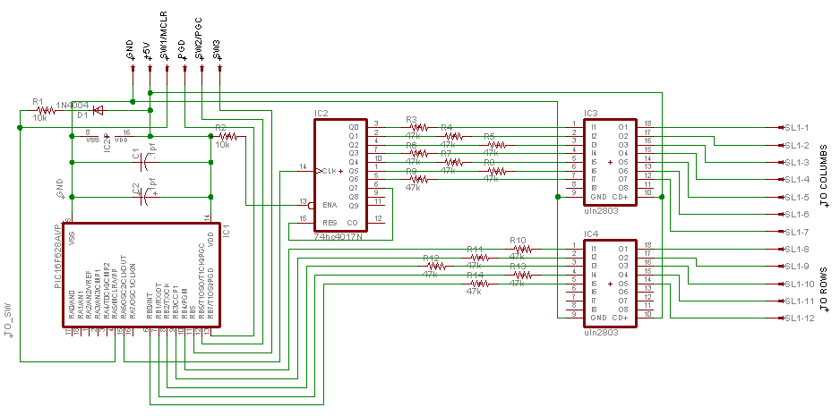

revised control board
charlie_r
As was suggested by blueroomelectronics, I have revised the control board for my LED light system, to avoid a possible dim light output problem.
If I could get a review by several of you more experienced electronics gurus....
Couple of Questions:
1. Do I need to put pull-ups on my switch inputs [RA5, RB5, RB6]?
2. Are the 47KΩ resistors between the outputs and the ULN2803s too high resistance or will they be OK?
Not sure you need the 47K resistors. You should be able to drive the 2803 darlington arrays directly.
BUT they are all cathode drivers, you need PNP transistor to drive the anodes.
I wish you continued the same thread as before because here you start half-way through and we don't know what your circuit is supposed to do.
Do you have an array of LEDs in rows and columns?
Are the LEDs burned out by the ULN2003 ICs? There are no current-limiting resistors.
The ULN2003s cannot drive the LEDs anyway because their output only goes low. You need the rows to go high since the columns go low.
The input switches are not shown (do they go to ground?) then they probably need a pullup resistor.
The 47k resistors cause trouble and are not needed. The ULN2803 has a resistor built-in in series with each input.

Yes, I am trying to drive an LED matrix, essentially 5 rows x 7 columns. The reasoning behind the darlingtons is I will be wanting to drive the LEDs with around 30mA+. From what I've read on the 16f628a datasheet, it can only source or sink 25mA max. Or did I miss something in there somewhere? Only one LED will be lit at any given time, using POV to make it appear solid.
I missed the 2.7K resistor when I looked at the datasheet for the 2803.

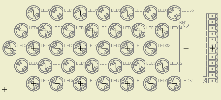

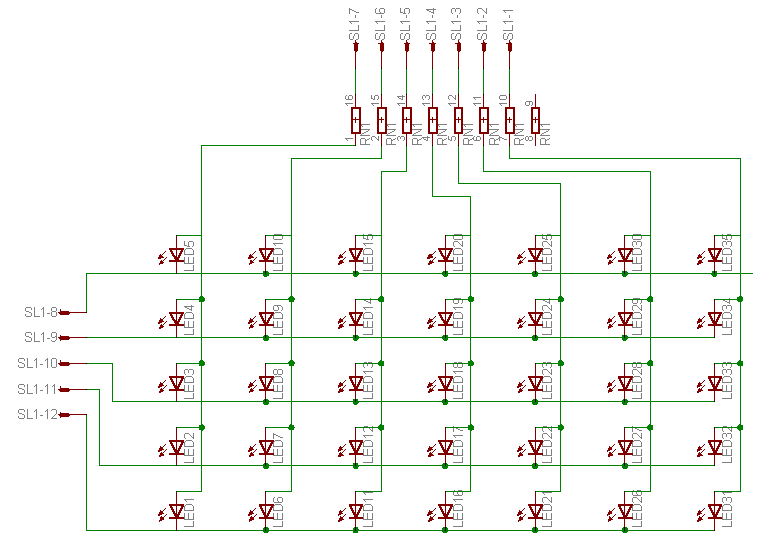

Here are the attachments from the other thread:

I have the LED board set up with anode connected to the 4017, common cathode on each row connected to the 16f628. So what you are saying is that I should reverse the LEDs to common anode?
I was planning on going low with the rows, until Blueroom said I would need transistors to drive for brightness. That is why I changed the control board schematic.

The 4017 has an output current of only typically 3mA into an LED when it has a 5V supply. Its minimum output current is only 1.5mA.
Then each LED will have an average current of only 3mA/7= 0.43mA or 0.21mA and look extremely dim.
You need to reverse the LEDs and add a driver IC and transistors to get enough peak current.

???? according to the phillips family spec sheet for the 74HC/HCT series which I will be using, I see:
±IO DC output source or sink current for -0.5 V < VO < VCC + 0.5 V
standard outputs 25 mA
bus driver outputs 35 mA
Also, since only 1 led at a time will be lit, I see no problem with the total Vcc or gnd current max of 50 - 70 mA
I knew the old 4017 cmos was very low mA output, sorry if I caused some confusion.
I have tested these LEDs with a 555 driving at 1KHz and still had good enough brightness as seen from approximately 45deg angle. However, as these modules will be installed in windowed weather resistant boxes, the side view point may be moot.
Your schematic shows an ordinary low current CD4017, not a higher current 74HC4017.
If you operate the LEDs with a peak current of 25mA (the max allowed from the 74HC4017 and from the PIC) then their average current is only 25mA/7= 3.6mA which is pretty dim.
The outputs of a 74HC4017 and a PIC have a voltage drop of about 1.3V each when the load current is their max allowed of 25mA. Then the current-limiting resistor value depends on how strong is the output from each IC since some have more current and others have less.

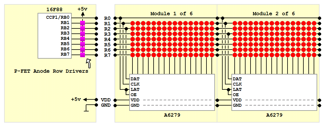

Hi Charlie,
Blueroom's name is Bill...
As the others have mentioned, you need to supply peak current of approximately seven times the average current to light the LEDs to full brightness at a 1/7th duty cycle. For 20 ma "average" current and full brightness you will want to drive each LED with approximately 140 ma at a 1/7th duty cycle.
You could always throw a bigger PIC with more pins at the problem but there are better approaches. For example, the design below provides a simple 10 pin buss between LED modules (8 data pins and 2 power pins) for a full brightness display with PWM brightness control. You could use a design like this to provide 50% brightness "tail lights" with 100% brightness sequencial turn signal indicators. Lots of possibilities.
Best wishes... Regards, Mike
<added>
I should probably explain that the 8 pin row driver buss is providing double duty in this design. Since the PWM signal from the PIC is driving the Latch and Output Enable line on the sinking driver ICs, I use the other pins on the row driver buss temporarily during the display blanking interval (when the PWM pin is high) as <clock> and <data> lines to load the driver IC shift registers before the PWM pin goes low to turn on the display.

Mike, can you answer a question about that MIC5821? I was just looking at the datasheet and really got confused. When they talk about latching, they are saying that the output port would stay in whatever state until a reset signal is sent through changing it's state, regardless of what the other pins do?
There's two basic parts to the MIC5821 (and other 8 bit serial-to-parallel sinking driver ICs). You use the <clock> and <data> pins to serially load the 8 bit shift register. You strobe the <latch> pin to copy the contents of the 8 bit shift register onto the output pins of the driver.
Other 8 bit serial-to-parallel sinking driver ICs to look at are the TI TPIC6C595 (150 ma) and the Allegro A6821 (500 ma). There are also 8 bit and 16 bit constant current sinking drivers ICs available which use a single Rset resistor to set the current which eliminates the need for current limiting resistors.

Thank you Mike for that explanation.
Another question about that method. Would that make the programing of the PIC easier or more complex?
It's probably about the same as any multiplexed display driver.
Basically I use a display array in RAM which corresponds directly to the LED matrix. Your main program simply sets or clears bits in that array to light or extinguish the corresponding LED in the matrix. I use an interrupt driven display driver to load the driver shift registers from the array one row at a time each interrupt.
There's some extra "data bender" code in the interrupt driver which sets up 8 special "shift register" data bytes which are thrown onto the buss at the beginning of the next interrupt (when PWM is high and display is off) to load the display driver shift registers in parallel.
