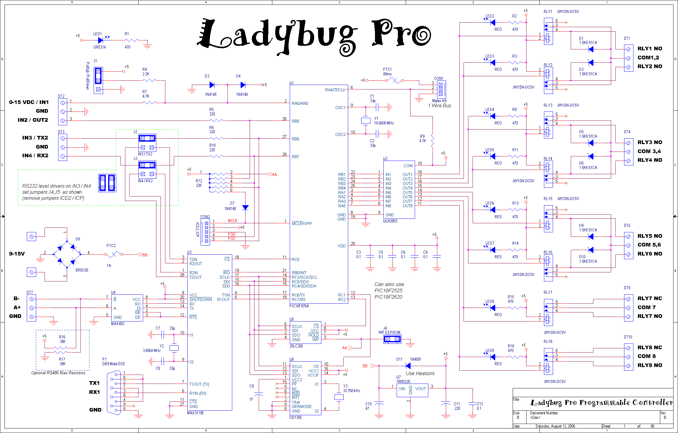

Revised PIC project Ladybug Pro Comments?
This is the new Ladybug Pro controller. It's not a finished schematic but 98% complete. I'm looking for comments and errors in the design.
It was designed primarily as a HVAC master controller similar to the base unit on the RCS thermostats. **broken link removed**
The main unit(s) (temperature sender) would be any version of the Cricket thermostat using RS485 would also allow for easy zoning.
It could also do things similar to a baby JDS Stargate, ELK Magic or Ocelot. IMHO.
The Ladybug Pro has:
  • Real time clock with supercap backup
  • 256K EEPROM
  • RS232 via PIC USART
  • RS485 via external UART
  • Eight Relays; six have clamping diodes (I may add four more for the NC/NO relays)
  • iButton / 1-wire support
  • 1 analogue or digital input
  • 3 digital inputs
  • support for ICD2 / ICP (Might make a nice development board)
  • 16F876A or 18F2525 CPU
Feedback always welcome.

Could you describe the intended function please? It seems you use another device or controller to display data on an LCD and to perhaps setup or edit the 'zone' temperature set points.
Does this unit monitor up to eight 'zone' temperature sensors and simply drive relays at the correct setpoints?
why use the ds1305 if you aren't using int0 or int1? the ds1302 is smaller (cheaper?) though it has less nvram.

Its intended function was to connect to a multistage Heater / Air Conditioner. RS485 sensors (like the Cricket or the unreleased very simple Moth).
Although it has only eight relays more (a typical single stage HVAC will use three Heat/Cool/Fan) you can use the remaining relays to control dampers. As an added bonus the new Cricket pro supports a single relay (more can be added with the EXP connector) You could control heated floors or vents with the single local relay. A high-end Aprilaire 8870 for example has 6 relays and an RS422 port. **broken link removed**
Ideally, one or more Ladybugs can control many (32 or more) Crickets at a distance up to 4000' or other RS485 devices; while the RS232 port be controlled by a small HA server or Ethernet to RS232 bridge.
Of course you can program it to be much more (or less) than that.
With the right software (I'd like to keep it as open as possible) you could easily emulate something similar to an ELK Magic MM443 **broken link removed**

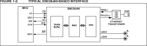

Thanks Mike, I've been debating if I should add a connector so you could omit the MAX3110 UART and add a PIC ENC28J60 Ethernet instead. Might make for a pretty neat development board.
I've also been tossing the idea around of using TIMER1 and a 32KHz crystal for the RTC functions instead of the DS1305.
It means using a 40pin 16F877A or 18Fxxxx as I could use the extra I/O. It would also mean enough I/O for an couple of extra features...

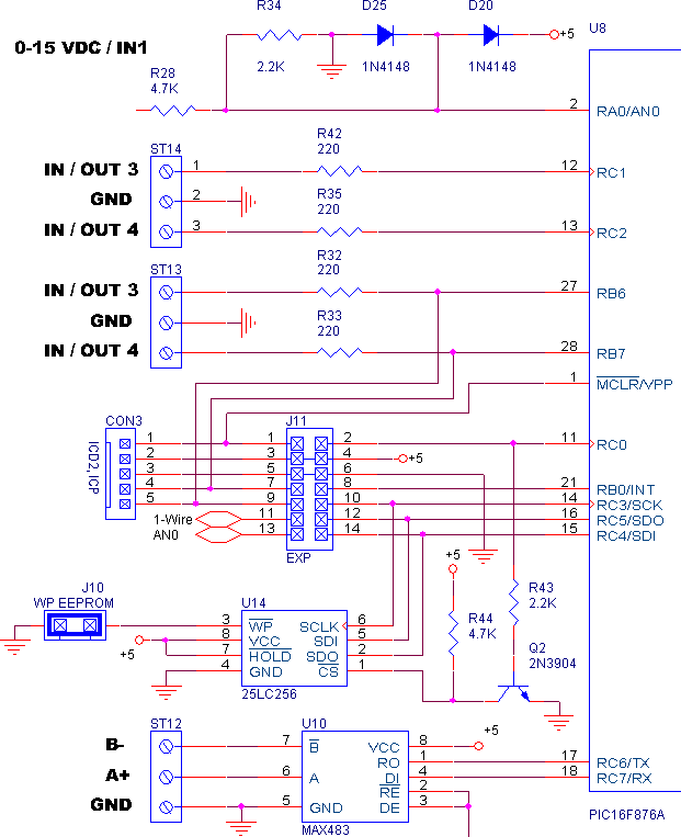

William At MyBlueRoom said:
What sort of problem? As far as I can tell it's very similar to the ELK-MM443 A/D input (although the ELK has 4 A/D inputs). The ELK uses a PIC16C76 CPU @ 4MHz
https://groups.google.com/group/...
Well on the "pulldown" setting, it'll divide the 15V into 5V nicely and default to 0V, but in the "pullup" setting, you'll end up with an input voltage range of -10V to 5V, and any logic level signals you dump into there are going to be mapped into the 3V to 5V region which won't be read properly unless you use the ADC which isn't exactly clean.
I'd probably put a 10K or so resistor between J1 and the connection to VCC so that it doesn't act like a voltage divider in "pullup" mode

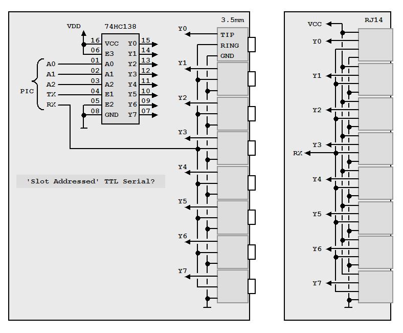

Speaking of multiple serial connections... I was thinking about using something like the drawing below for managed multiple short distance TTL level serial I/O. The 'master' manages port selection and serial traffic so that only one 'slave' is ever answering a message initiated by the 'master'. The TX line on the slaves would probably need a 2N7000 open-drain driver with a single 2N7000 on the 'master' PIC RX line. As I mentioned before, using RJ14/RJ45 connectors would allow the 'slaves' to be powered from the 'master' controller.
Mike

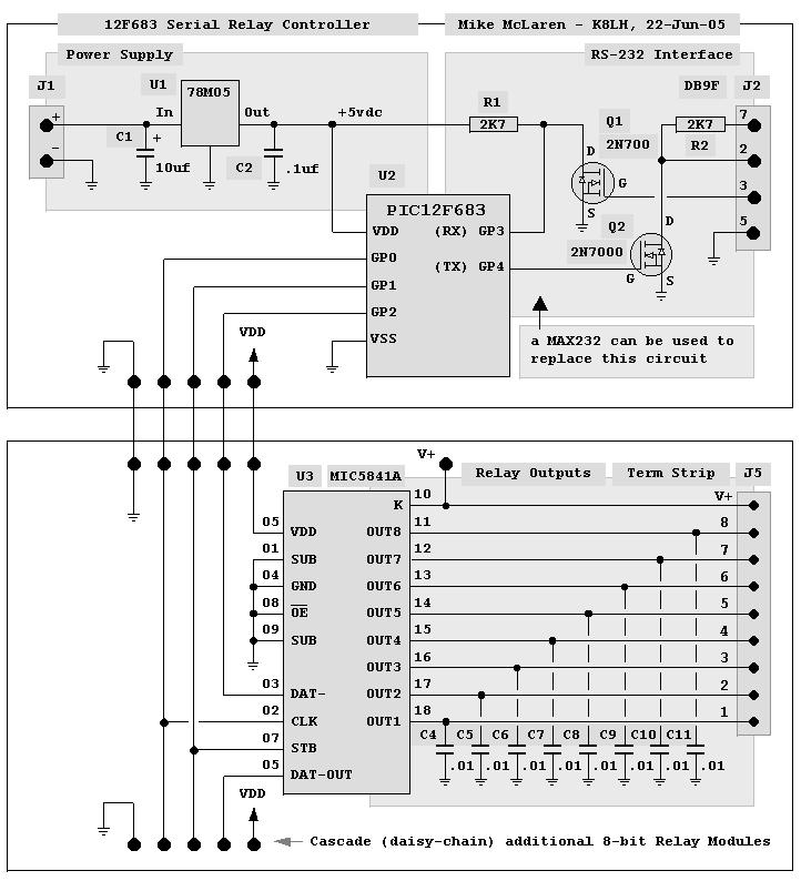

Speaking of 'glue' logic. Don't discount those Coto relays as you can drive them directly from a PIC port or an inexpensive 74HC595. Not to mention they use very little board space.
Remember too that you have a very powerful RS485 interface. Why not use it to advantage to offload some functions. The little relay controller below could easily be connected to an 8 pin RS485 chip.
Mike
As usual Mike your designs are compelling. I have a come up with a design that might just do the trick.
I've moved the RS485 to the internal USART.
I've removed the DS1305 from the design. (If you need a battery backed up clock a DS1904 iButton can be hooked up to the 1-wire port, OR you can use a Cricket Pro with clock EXPansion, OR Ethernet, OR Serial etc...)
And the MAX3110E is an option so you can choose between RS232 or Ethernet using a ENC28J60. Here's an example with schematic of the ENC28J60 (It has 5v tolerent I/O too)
https://www.olimex.com/dev/enc28j60-h.html
