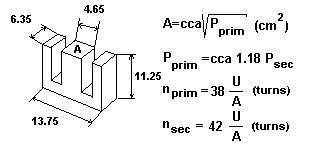

I want to rewind a large iron/steel transformer.
It has 'E I' plates that measure 5.5 x 4.5 x 2.5 inches.
It has a 4 to 1 ratio [2" - 0.5"] spacing on the "E".
The old windings are coated copper ribbon 1/16 inch thick,
essentially solid copper bar with no resistance.
I want 50 v - 0 - 50 v [100v center tapped] on a 120vac primary.
What wire size and turns-length would I need?
Thank you kindly.
This very simplyfied formula work for me about 20 years...
The iron core carry about 870VA (A=29.5qcm)
Turns of primary 155 (1/16inch, enough for 7.5A)
Turns of secondary 2x71 (center tapped) 1/16 inch

Hello Mosfet, i can help your problem. please give me the exact size for center tapper and the thickness of your E core.
Thanks rebottex,
The core [or "A" in Sebi's diagram] is 1.125 x 2.625 inches.
My calculations give me about 350 watts to work with.
Too little for the 100 volt AC center tapped 6 amp windings I wanted.
I could get 80vac CT at 3.8 A or 76vac CT at 4 A.
I think the original purpose was spot welding 10 volts at 30+ amps.
