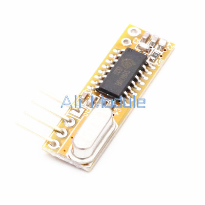

I want a EV1527 type decoder that can interface with micro controllers. All I found in ebay & aliexpress has only 4 outputs.I need more remote supported (more than 4).Is there any data module in this? So I can read incoming data & store in MCU. In this way I can store more than 4 inputs.

I understood the method you using.
In my case I like to stick with EV1527 devices because there are several wireless transmitting devices are already built nicely.Ex : Door Contacts, PIR etc.... Those are really cheap & nice......The working distance also not bad at all.....Those are really cheap in ebay, aliexpress etc....So no need to worry about these transmitters.
All I need to build a receiver which decodes these protocol.The thing is I did not find one which sends the data out instead of separate bits... :(
Ok, so you need to do the decoding in software, then you can recognise each different transmitter code and store the data from it separately.

You got it. That's what I need to do.
But what module do I need.I couldn't find a module which sends data out until now.
That depends on the frequency and transmission standard (AM or FM) of the remote transmitters you are going to be using?
Give a link to an example device that has full specifications and I may be able to point you to a suitable receiver.
Hi, Here is the one I need to read.I use 433Mhz ones.
Those are listed as 433.92, Amplitude modulation.
Something as simple as the RX from a kit like this could work, though a slightly more sophisticated one may work better for range and sensitivity - though that would not affect the software side:

That's really cool.I have those receivers at home.So I should start doing a code.The EV1527 timing protocol is critical with 1uS gaps...Anyway Like to try it.
Many thanks for the help.
No, it's very relaxed!
Each "unit" time with the signal on or off is around 300 - 500 uS.
A start pulse is one unit on and 31 off, the data bits are one on & three off for low/0, or three on & one off for high/1
You need to capture the start of each "on" pulse, then check if it's high or low (1 / 0 ) around 700uS later (so more than the longest "1 unit" time, less than the shortest "3 unit" time).
And check the time to the next pulse start - if that is more that eg. 10mS it was a start bit, if no more than about 2mS it was a data bit.
If you use a PIC that has "input capture" a lot of the timing can be hardware and you just wait for new edges to be captured.
You could also capture falling edges and measure each pulse & gap length directly.
