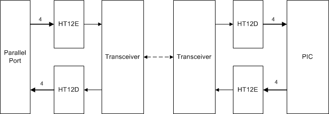

I am trying to establish an RF link with the PIC to control a car using a PC parallel port.
I planned to do it this way:
The 4 inputs from the Parallel port represent (forward, left, right, brake)
The PIC listens for signals from the parallel port at its I/O pins. If a 1 0 0 0 is sent, then the PIC will know it is going forward.
The PC should also be able to monitor the condition of the car battery and temperature. Unfortunately, seems like there is only 8 data pins for the pc parallel port. So the other 4 pins is used for monitoring purposes.
Unfortunately...again, the ADC for the PIC is 10 bits, so i am having trouble sending the info back in 4 bits.
Any advice?

Spectacular Butter said:
Thanks for replying.
Any advice?
This seems rather a waste of four perfectly good Holtek IC's!.
At the PC end the PC can feed the transceiver directly (with software running in the PC), at the remote end a PIC can do everything the Holtek chips do at that end. The Holtek IC's aren't designed for this use at all, but for simple ON/OFF remote control applications - so they are a very poor choice.
The PIC having a 10bit A2D is irrelevent really, if you want to use it as a four bit A2D simply use the top four bits!.

That's exactly right, if you only use 4 bit resolution, you only have 16 possible states. You can still monitor a wide temperature range - but only with really poor resolution - 4 degrees resolution over a 64 degree range.
The entire idea with the Holtek remote encoders is seriously flawed.
