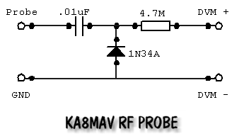

I am interested in building a simple RF detector. One that vibrates upon the presence of RF signals would be great. I would like to use this item as part of a counter surveillance kit that i am putting together. Has anyone built one, or does anyone know where I might be able to find plans to build one? Thanks for reading.
Its not quite as simple as you might think :wink: . RF covers a rather wide spectrum nowadays and any detector would have to be frequency specific to detect weak signals. If your detector is too broad banded you would soon get annoyed by all the false readings from the RF noise everywhere around (if you live in a city).
Your detector would need a tuned aerial and an amplifier. A vibrating output is rather novel, most people would settle for a meter or some indicator lights to show signal strength.

You can try building this circuit here, if you connect it 2 a voltmeter, it will show voltage, the diode has to be germanium type (at least thats wut it said on the website) u might be able to use something else (but dont quote me on that) i didnt put the cap on cuz @ the time i didnt have one but the circuit still works. i think its there to filter out power lines frequencies (60 hz here in america). gnd doesnt have to be connected to anything, its there for better sensitivity if youre testing out an RF circuit. put ur voltmeter on a low voltage setting, like mv.
I think that this circuit should work w/ high frequencies. dont build it until someone verifies this cuz im not sure. the thing that im not sure about is if the diode has to be high frequency. i could look this up but am 2 lazy. if this circuit will work, you could probly make an amplifier for it or something, ill let someone else tell you about that. hope this helps :D
You gotta have high frequency diodes. Best way to find out if it's high frequency... crank up the frequency generator and try it out. A simple DC Diode check to see if the diode works won't do it...
