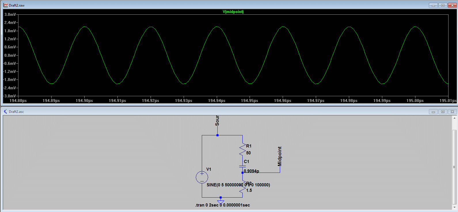

Take the example of a short wire antenna with a true impedance of 1.5 -3500j at 50 MHz. Suppose we construct a voltage divider with the antenna in series with a pure resistance of 50 ohms, and feed 10V (peak_to_peak) RF across it. Attached is a screendump of the LTSpice simulation for this situation, with the antenna at the earthy end of the potential divider. The graph above shows the voltage between the antenna and ground. As you can see, its very low. The reason I want to be able to measure low RF voltages is not because I don't want to feed high RF voltages into the setup, but because the voltage across the antenna is so low. It would be overwhelmed by diode drop for example.

The 0.9pF cap is much of the problem. At 50mhz there is a great deal of loss in the cap. You have a low frequency block filter where 50mhz is considered low frequency.
OK..... I will say something about 1.5 ohm antennas. You don't connect then to a 50 ohm source.
A 50:1.5 ohm mismatch coupled with a cap that will block 50mhz gets you from volts to almost nothing.

ronsimpson: Ron, I told you I was looking at electrically short antennas;). Try running a lambda / 10 monopole thru an NEC program and look at the impedance that it spits out. It would be something like 1.5 - 3500j (ie short wire lengths look to the RF source as capacitors, their radiation resistances are miniscule relative to their susceptances. Instead of signals getting radiated into the far-field, you get energy trapped in the static near-field because the susceptances are so high. The 0.9pF cap in the LTSpice simulation was my way of simulating the antenna susceptance of -3500j @ 50MHz. I agree that 50R is too high to put into a voltage divider with such an antenna impedance. An ideal real resistance would be 5R. But that combination would require too much power from a typical instrumentation wideband RF source, because the total impedance is so low.
