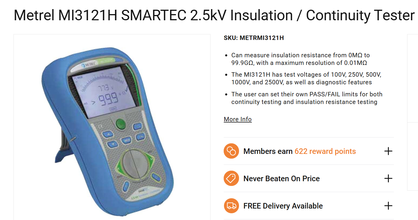

What are dBP.P ?
A quick googling says that this is an insulation and continuity tester.
I am confused, can you provide more information?

Is this what you are trying to test?
It does not seem to me that it has a synthesised signal source of any kind, that would need the services of a spectrum analyser to do tests.
Please correct me if I am wrong.
No, he is working on an MI Technologies MI-3121 Synthesized Signal Source.
OK, that makes more sense.
Putting
MI technologies syn MI-3121
Into MS Bing led me to the insulation tester which I showed above.
A fine search engine that is!
I find it appropriate that "bing" is the Scottish word for a coal mine spoil heap.
Google and Duck Duck Go also led to the same place - search engines really have turned to next to useless over the last couple of years and now with AI sticking it's nose in, they are getting worse.
