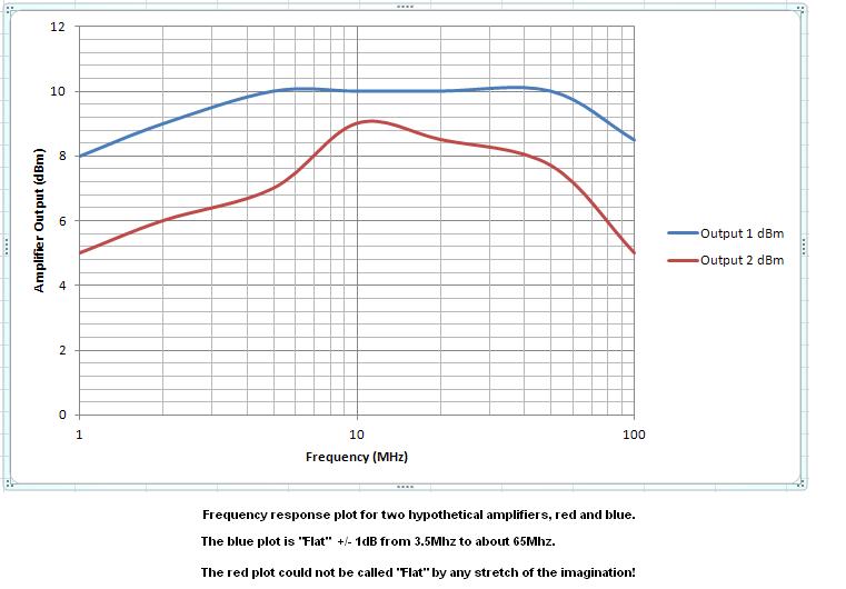

2.) Gain Flatness
Measure the gain at various frequencies.
The difference in gain at the different frequencies is an indication of the "Gain Flatness".
A better term may be "frequency response"

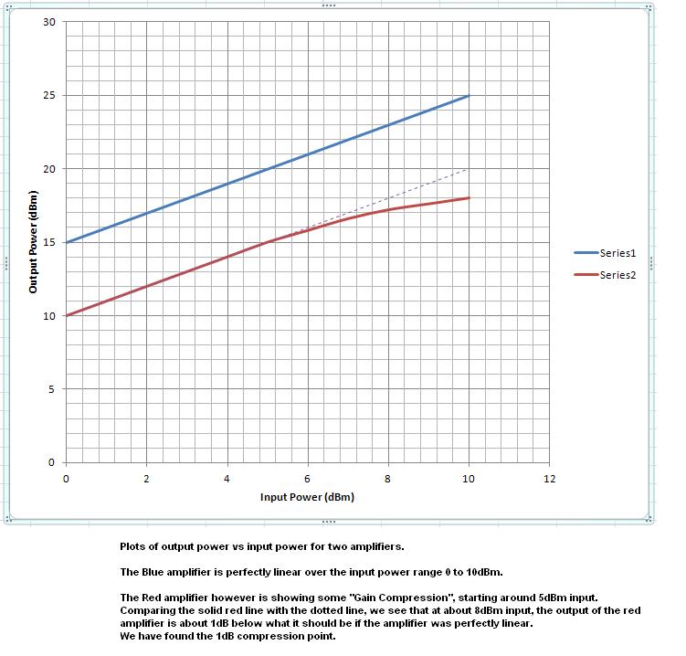

Gain Compression.
As the signal through a (linear) amplifier is is increased, at some point the output will be less than the input signal multiplied by the gain.
To measure this, plot the input and output voltage or power of the amplifier and you will find that the gain drops off at some power level.
The 1dB Gain compression point is where the output power is 1dB lower than expected from the input times the small signal gain.
Why is it called Gain Flatness?
How do you know what output voltage is 1db lower than the input? is there a simple formula for this?
it means exactly what it says ... if the gain is flat over a particular bandwidth say 20MHz ... then the gain doesn vary over that bandwidth. A flatness tolerance may be provided ... eg plus or minus 1 dB
Jim didnt say voltage, read his comment again ... its referring to POWER = P1 dB output = P1 dB input + (Gain - 1) dBm
to follow on from Jim's comments
here's my usual response to people who ask about 1dB compression.....
When operating within the linear region of a component, gain through that component is constant for a given frequency. As the input signal is increased in power, a point is reached where the power of the signal at the output is not amplified by the same amount as the smaller signal. At the point where the input signal is amplified by an amount 1 dB less than the small signal gain, the 1 dB Compression Point has been reached. A rapid decrease in gain will be experienced after the 1 dB compression point is reached. If the input power is increased to an extreme value, the component will be destroyed.
Have a look at the first graph which I have knocked-up. (UK meaning, not USA meaning!)
No formulae that I know of.
You have to make some plots of input and output power and look at the graphs.
So, look at my second graph.
