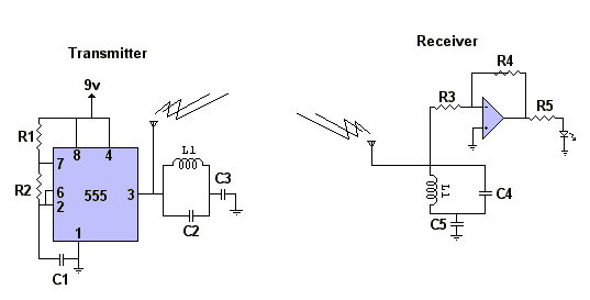

now this is my first rf project i attemp to build , i wanted to use linear ICs cause they make things a litle easier and with less error factor!
now i've got those 2 circuits from an old printed sheet, but they dont work at all.. the emiter seem to be working cause i am getting kind of disturbance in a nearby fm radio.. but i dont know , please send me corrections.
l1 and l2 are 5 truns copper 0.5 cm diameter 1 cm length without a core inside.
i have experimented with many many values for resistances and capacitors.. so now i am so confused!.. i would apreciate giving me ideal values (approx.) for the resistances and capacitors.

From your discription of the coils the frequency my be for the standard broadcast band 88-108Mhz. The actual frequency for the transmitter is determined by the inductance of L1 and the capacitance of C2, plus other capacitance in the circuit. The output of the 555 timer is a pulse wave form that may excite the tuned circuit, but as far as modulation that is questionable.
The receiver circuit has no detector between the tuned circuit L1 and C4.
The op amp is a standard amplifier, and will not respond to the RF of the input unless it is low in frequency.
You might post the values of the other components so we can help you better.
Maybe the designer thinking with BJT input opamp, and the first e-b can work as rectifier.
