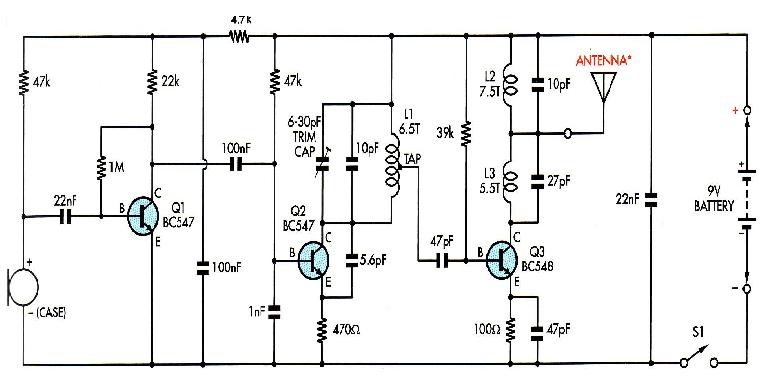

Please post the schematic with parts values for your transmitter.
I suspect that two stages are audio and the oscillator is directly connected to the antenna. The antenna is part of the tuned circuit and causes the transmitter to change frequency when you move it or move around it.
When i say null off i mean the sound, drops off but there is no white noise. This means that the oscillator still works but it has zero modulation signal.
here is the shematic as wanted:
This is an MOPA (master oscillator, power amp) design, much better than I expected. A shielded box is all you should need, connect the common of the circuit to the box. You should not expect to be within 3 cm of the antenna without absorbing most of the signal.
Its antenna is oddly connected between two high impedance tuned circuits. Even though they are staggar-tuned to try to cover the entire FM band, they make a poor match to the low impedance of the antenna.
Its electret mic is powered by a 47K resistor. I use 10K in my circuits and I've seen some with only 2.2K. With 47K the voltage across the mic is close to nothing.
The supply bypass cap for the preamp and mic powering resistor allows gain-reducing negative feedback at audio frequencies. The circuit needs an additional 22uF or 100uF cap there.
Maybe the radio mutes its output when it is close to the transmitter or when your hand is near the transmitter, boosting its output. Cheap FM radios don't have tuned circuits at their input, allowing strong RF at any frequency to overload their input transistor or mixer.
