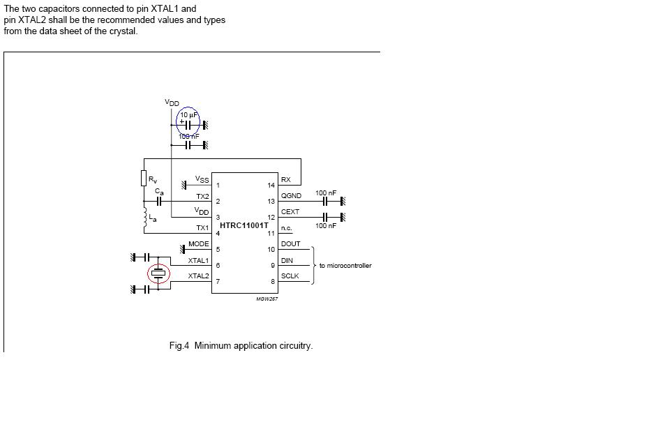

I'm attempting to build the circuit in this RFID chip's white-paper. It left something vague however.
rfid-crystal-png.33164
I can't figure out what these two capacitors by the crystal should be. I've read the data sheet for the crystal from top to bottom and it says nothing to this effect.

The component in the red circle is a crystal, and the component in the blue circle would probably be a tantalum capacitor. The 100nF caps depicted to the far right would probably be ceramic caps. Hope I've answered your questions!

The crystal datasheet will specify a load capacitance. That load is split between the 2 capacitors in parallel. Capacitors in parallel work like resistors in parallel. Typical values might be in the 12-30pf range. They help to guarantee that the oscillator will start up reliably.

The two capacitors are in parallel with the crystal. They are in series with each other.

Given this:
The total capacitance seen from the crystal looking into the rest of the circuit is called the "load capacitance". When a manufacturer makes a "parallel" crystal, a technician uses a Pierce oscillator with a particular load capacitance (often 18 or 20 pF) while trimming the crystal to oscillate at exactly the frequency written on its package.
To get the same frequency performance, one must then make sure that the capacitances in the circuit match this value specified in the crystal's data sheet. Load capacitance CL can be calculated from the series combination of C1 and C2
I get this formula:
1/20 = 1/x + 1/x (20 is the crystal capacitance)
Doing the math you get
x/20 = 2
x = 40
So I need two 40pf caps? This seems rather large...
