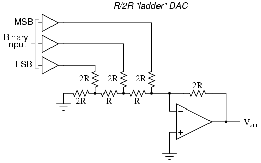

Actually with latching shift registers it's simple in both hardware and software, it just requires a lot of simplicity to do =) Many shift registers and resistors on the hardware side, and bit mapping on the software side to make it human readable. The actual complexity is very low, each unit is quiet elegant, there are just hundreds or more of them. Shift register R2R DACs with carefully chosen resistor values will give you a bright display and at least 16 levels of brightness. If you want fluid dimming you'll need 8 bits minimum (I'd aim for 10) Which is just as readily doable but now you're talking 2700 bits worth of shift registers and resistors. That's for a fully static display that will give you a practical display refresh rate of 370FPS with a serial clock of only 1mhz...

Scead: Do you have an example of R2R?

R2R Example:
Not sure where the outputs are drawn for this circuit. One output?
