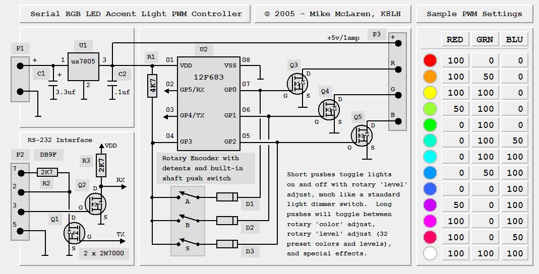

Hi Guys,
Evandude's example is excellent... I plan on doing pretty much the same thing but from within an interrupt service routine... Here's my design concept (below) which I hope to wire up during the long Thanksgiving Holiday weekend...
Full duplex bit banged serial I/O with 16-byte circular receive and transmit buffers is accomplished using 3X bit rate interrupts (google "16F819 Serial" for an example on PICList) and I'll use that same interrupt cycle/rate to drive the PWM counters and LEDs...
Regards, Mike
