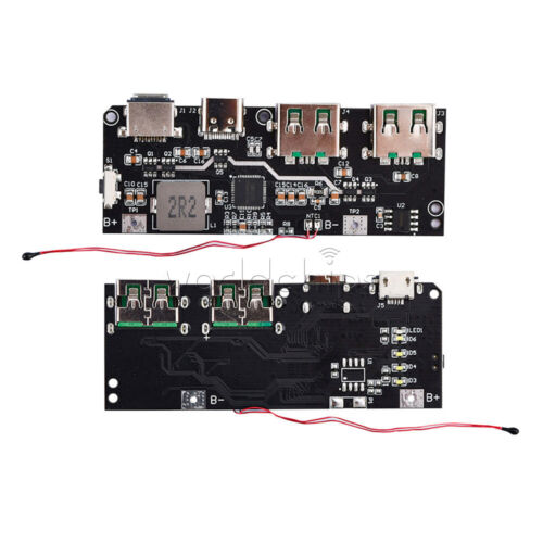

You could use an off-the-shelf RGB LED kit?
Things like this are readily available on ebay & amazon etc.
The only other change would be to use a "power bank" module [or power bank] to both charge the battery and provide a 5V output, to run the LED system.
eg. Two wires from the battery to one of these, then everything just plugs together:
