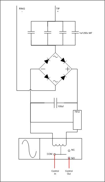

I have searched the web and cannot seem to find a solution that I can just buy to meet a need I have. I did find a kit online but it is from the UK and I need to get this done quickly.
I have found solutions that are far more complex than what my needs are at the moment.
What I am trying to do is to design a circuit that will identify when a telephone line rings and then trigger a relay to close a contact. I have the first design and build done, but I have an issue everytime I connect the relay.
What I have is 4 metal film capacitors (250V 1µF) in parallele to each other for capacity but in series with the tip side of the phone line. This removes teh DC voltage and provides some torage of the AC voltage when the phone rings.
I then have a full-wave bridge rectifier to convert the AC to DC voltage. I have a 100µF electrolytic capacitor for smoothing and then a 7812 regulator.
Everything works fine. I have 50VAC ring voltage into the circuit, 54VDC out of the rectifier (after the cap) and a solid 12VDC out of the regulator.
When I connect the coil of the relay the voltage drops to 3.3V and is not enough to fire the relay contact. I measured the resistance across the relay coil at 200Ω.
I tried using a 7805 regulator with a 5VDC relay and the voltage when connected is 1.5 volts and I have the same issue of not engaging the relay contacts.
I know that the 7812 should only have 35V on the input, but I have not had any issues (with heat or not having the 12V output) since the load is low current and the interval is 3 seconds.
It has been a long time since electronics classes and I would very much appreciate any help in getting this to work.

The output of your rectificer currently has about 40v to 50v on it.
By putting a 56v zener diode on the output of this, the voltage will not be present until the phone rings. The 56v zener can be made up of any values totalling about 56v.
Now take the output and feed it into the base of an NPN transistor with 10k between the 56vZener and the base. Put 10u to 100u between the zener and 10k and the other end to ground. Put 100k between base and ground. Now connect the collector to the coil of a relay and the other end of the coil to 6v or 12v. Be careful to put the zener so that the line on the zener goes to the bridge.
When the phone rings, the relay pulls in.

You are likely overloading the ring circuit. What is the rectifier output voltage when the relay load is connected and the phone is ringing?
You might try a relay with a 24V or 48V coil, which would have a much higher resistance.
54VDC
So could I add a resistor to make this work? I have had a hard tie finding a 24V relay coil locally.
What is the voltage and current of the relay load (the magnetic door latch), and is the load AC or DC?
The load is 12VDC and draws .5A
You cannot power a relay from the phone line. It is only capable of delivering about 20mA, and the voltage falls to about 5v to 12v at this current.

You can use a CMOS relay. We have 5v CMOS relays and they only require about 10mA for operation.

I did get a CMOS and tried to make it work with an external power supply.
Radio Shack did not have much of what I needed but I did find a local electronics shop. When I explained what I was trying to do the gentleman helped me out and had the components needed.
I will try to get a drawing updated and posted for future users, but it is pretty much what colin55 tried to explain to me.
The device works and I tweaked the capacitor size a little to maintain output throughout the ring cycle so the door would stay unlatched as long as the line was ringing.
