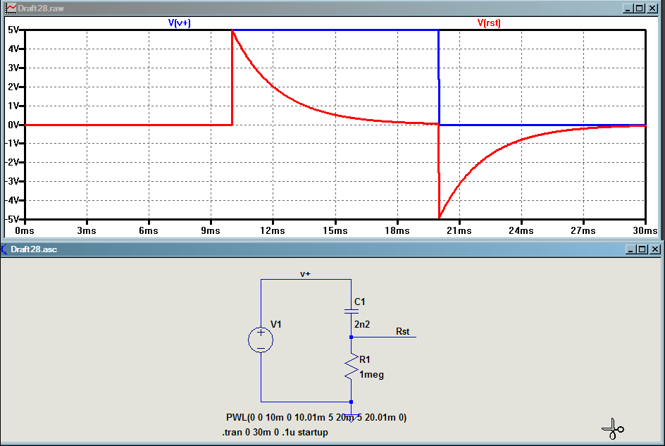

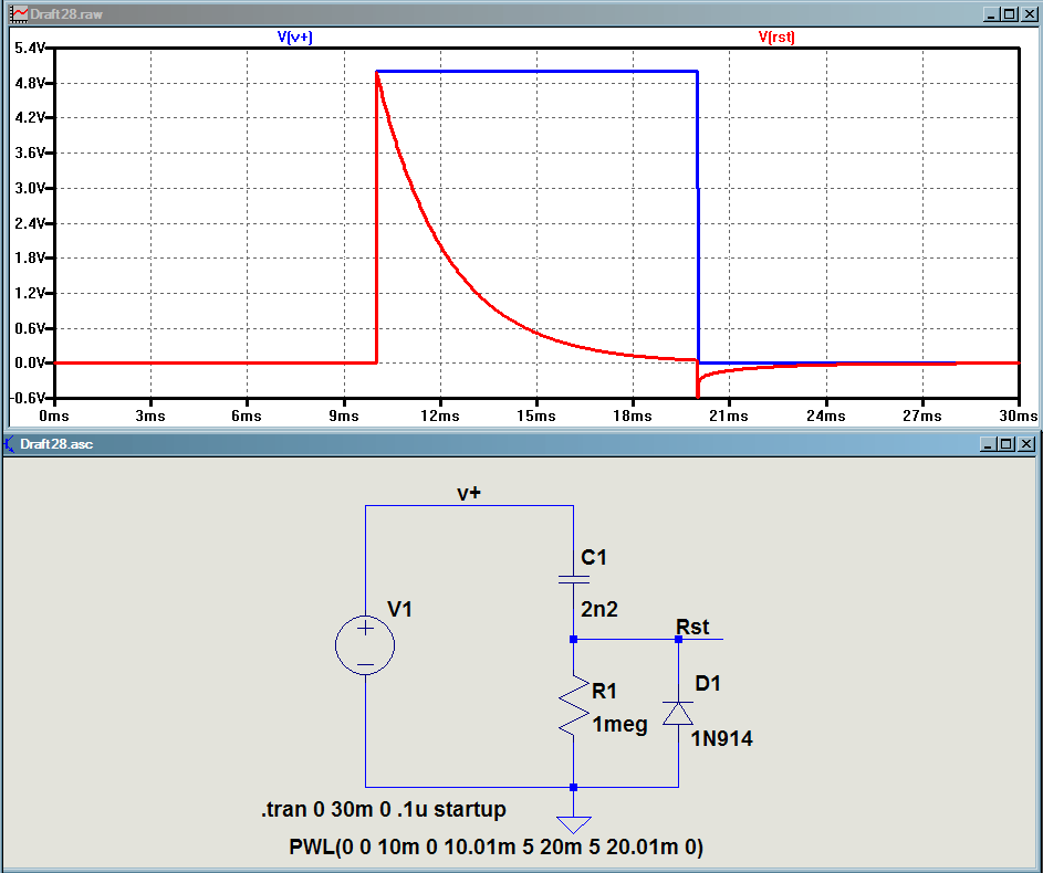

Look at this example.:)
EDIT: the 2nd image is with a diode across the resistor, this reduces the discharge time also the negative swing at the input to the following device.

The important point to note, is that when testing this type of R/C circuit is that its actually a simple differentiater and so the applied test pulse voltage must have a 'fast' rise/fall time, if you want to see the RESET waveform.

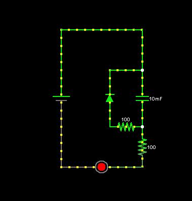

Here is my circuit, it's not the circuit i want, it's just a way of testing the discharge:

If that RED dot on your circuit is a n/o push switch.?? then as you push the switch the cap will charge, BUT as the switch opens the only discharge path for the cap is via the reversed biassed diode.
So it will [ with an ideal diode] take a very long time to self discharge.
Your test circuit is not a true analog of what happens in an actual circuit.
Try place a resistor in parallel with the cap, so it has a discharge path when the battery voltage is switched off.
The red dot is an LED :)
If I put a resistor in parallel with the cap, when the cap fills won't the resistor continue to power the circuit? In this case the LED?
