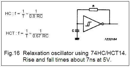

1/6 of a 74HC14 hex Schmitt inverter package makes an oscillator with only 7ns rise and fall times. They are so quick that I can't see them on my 'scope. :lol:

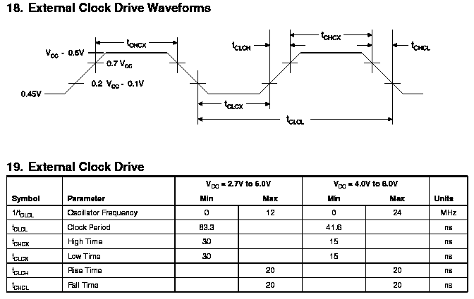

I'm trying to make an external oscillator which satisfies the AT89C2051 uC chip. But it requires a frequency < 24Mhz and a maximum rise time of 20ns and a maximum fall time of 20ns, and the value (0 or 1) must stay in one state for at least 15ns.
I think maybe there is a misrepresentation in ATMEL's docs.
I have to make the oscillator which meets the requirements outlined below. I don't have access to crystals at this time.
