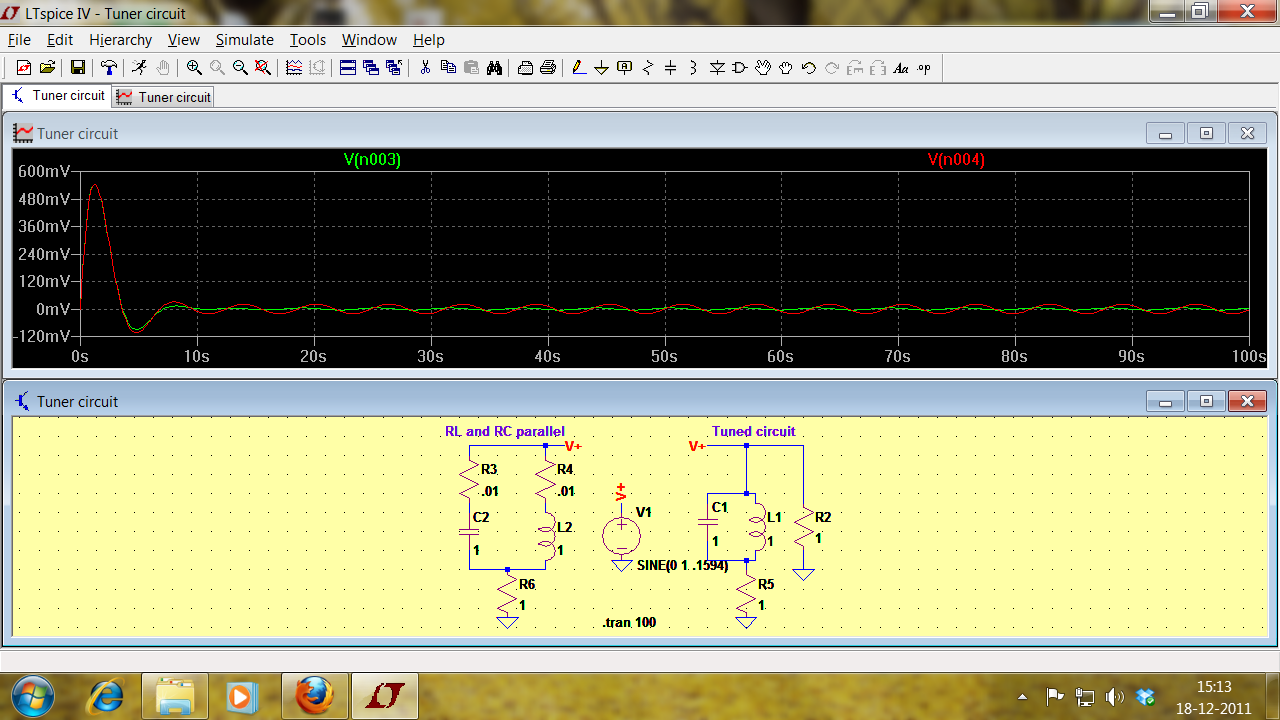

hello,
How can i make other circuit RC and RL in parallel to oscillate in resonant frequency.
  • Tuner circuit.asc

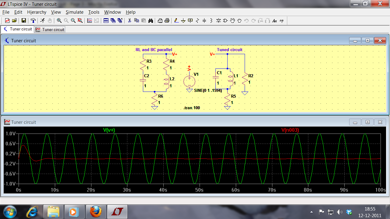

Do you mean like this,???
no i meant voltage at R6 resistance should die down to zero like it has done for R5 resistance
you can download to check it
aint nobody replying :(
That may be because we don't understand exactly what you are asking.:confused: Try rephrasing the question.
As long as you have losses within the parallel LC tank circuit it has to be replenished by current flowing through R6 in order to keep a steady state AC voltage swing across tank.

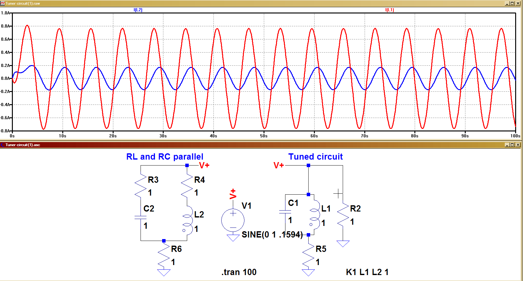

oh thankyou,
i reduced the resistance 100 times in L and C and now it is working same as tuned LC circuit
