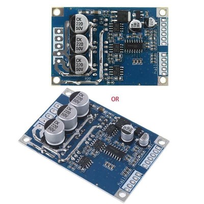

I ended up choosing wheel motors intended for balance boards, as they are capable of high torque at low speeds, with built in hall sensor position feedback. The drivers are like these, which area available on ebay & amazon etc. and detailed usage schematics are available for the controller IC; the boards match the diagrams. (The wheels were secondhand from ebay).
They motor controller boards are rated 36V max, but just need one component changing to allow for 42V from a fully charged battery.

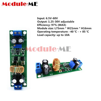

The buck regulator boards in the top right of the box reduce the main battery voltage, first to 15V which feeds the 12V electronics backup battery & also the upper two regs that give 5V for the computer and other electronics.
Like these, though I found mine from a UK seller:
(When buying any buck or boost regulator modules, get ones rated at least twice the maximum possible real load, as the advertisers figures are often imaginary or the "at-the-instant-it-exploded" values...)
