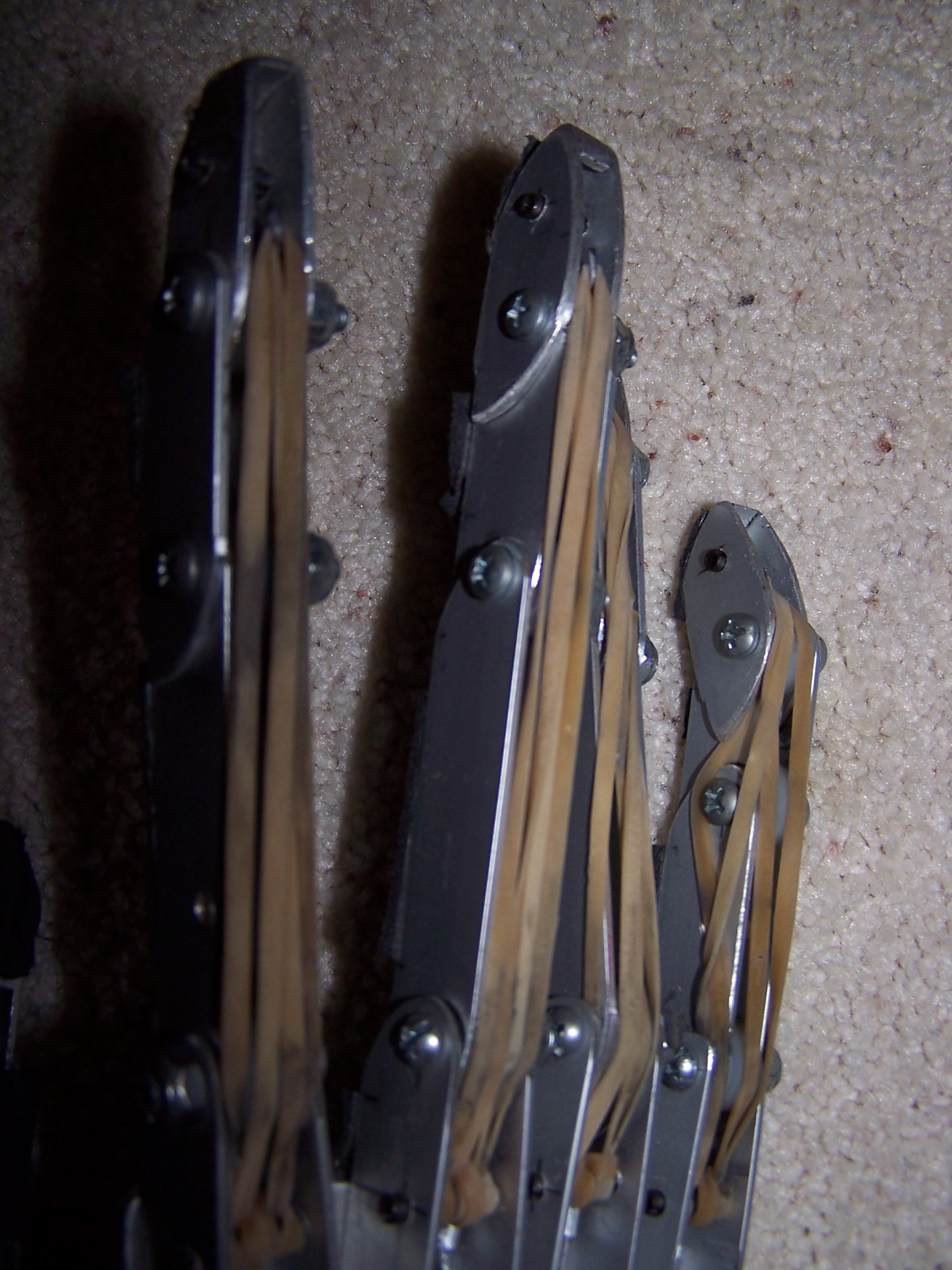

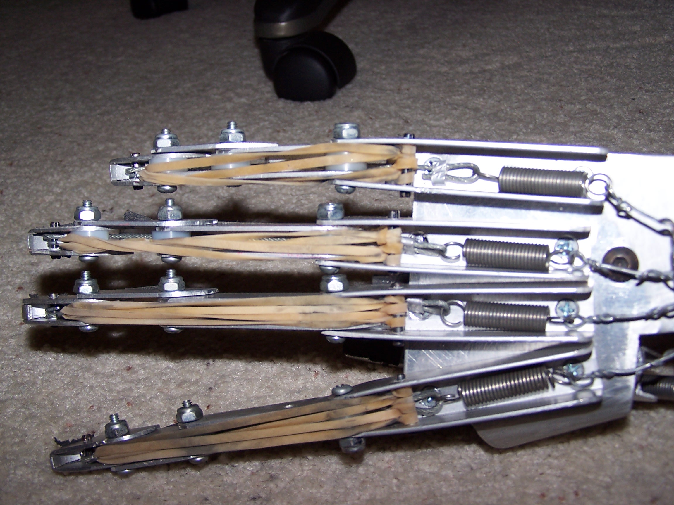

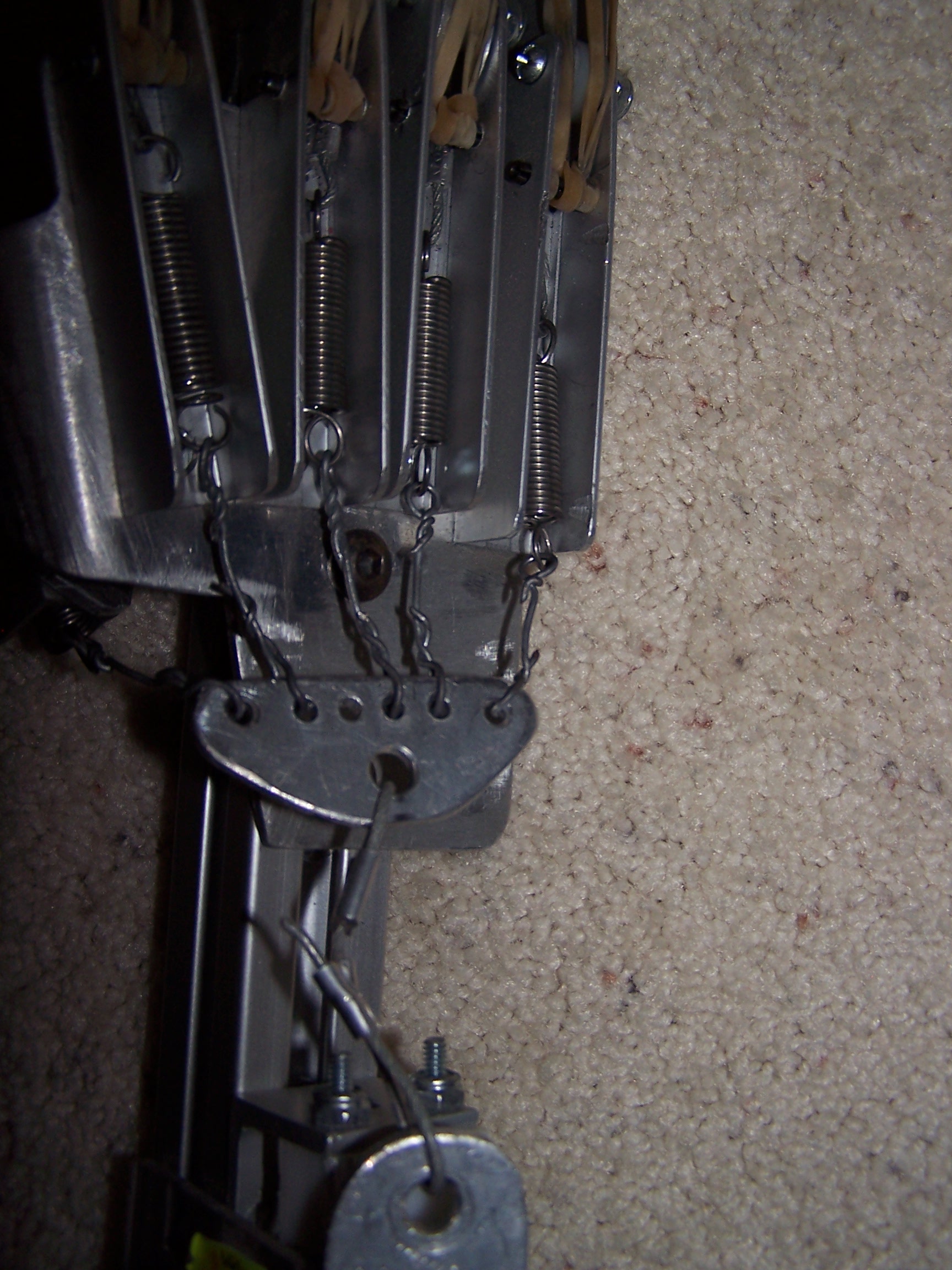

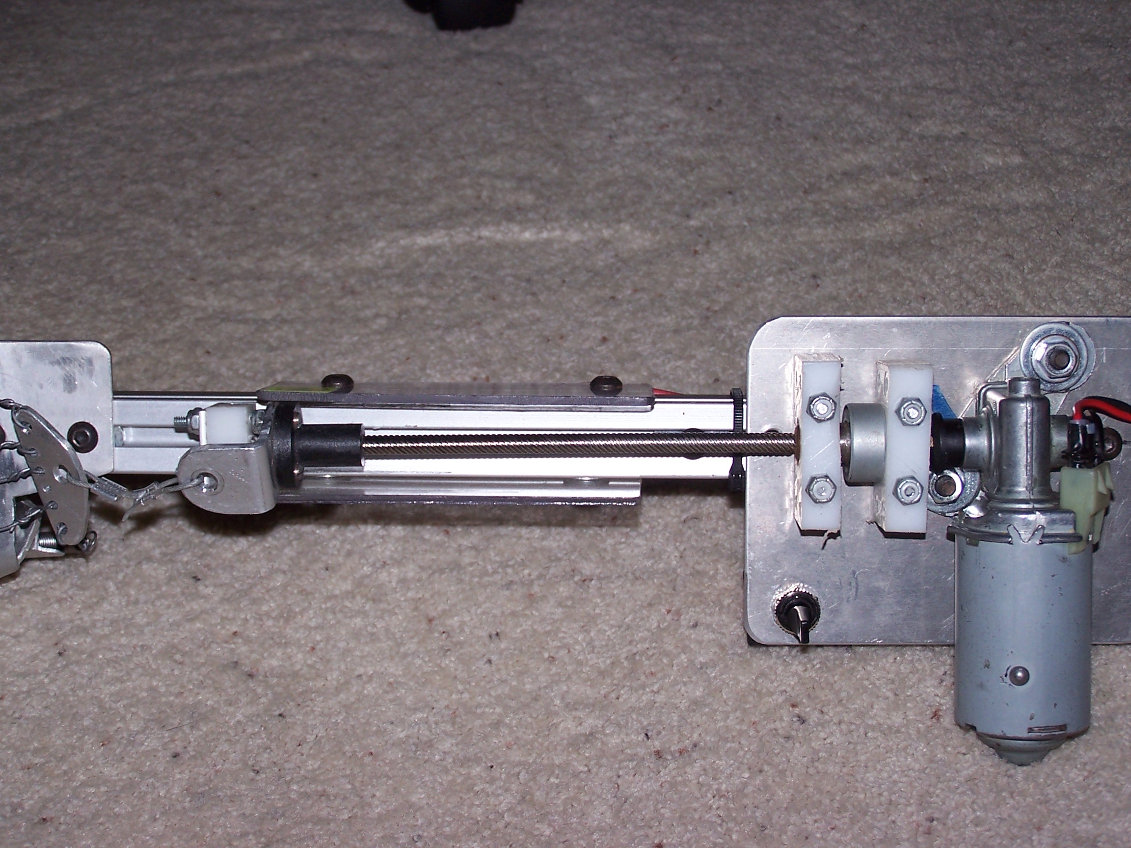

I need some Ideas for upgrading my High School's robotic hand. Right now, It runs on a motor (specs unknown) that turns a long worm gear that anchors a cable that pulls 5 wires that in turn pulls each finger closed. There is a Switch that controlls the motor going forward and backwards.
More to the point: They want me to upgrade the Hand so that it can move each finger individually. I have 2 ideas:

1324: Fingers of the hand. Rubberbands help the hand go back into original position. Tension springs are also shown, they help reduce over stressing the fingers.
1325: Picture of worm gear and motor. Anchor for cables are also shown in left hand side. Switch also shown.

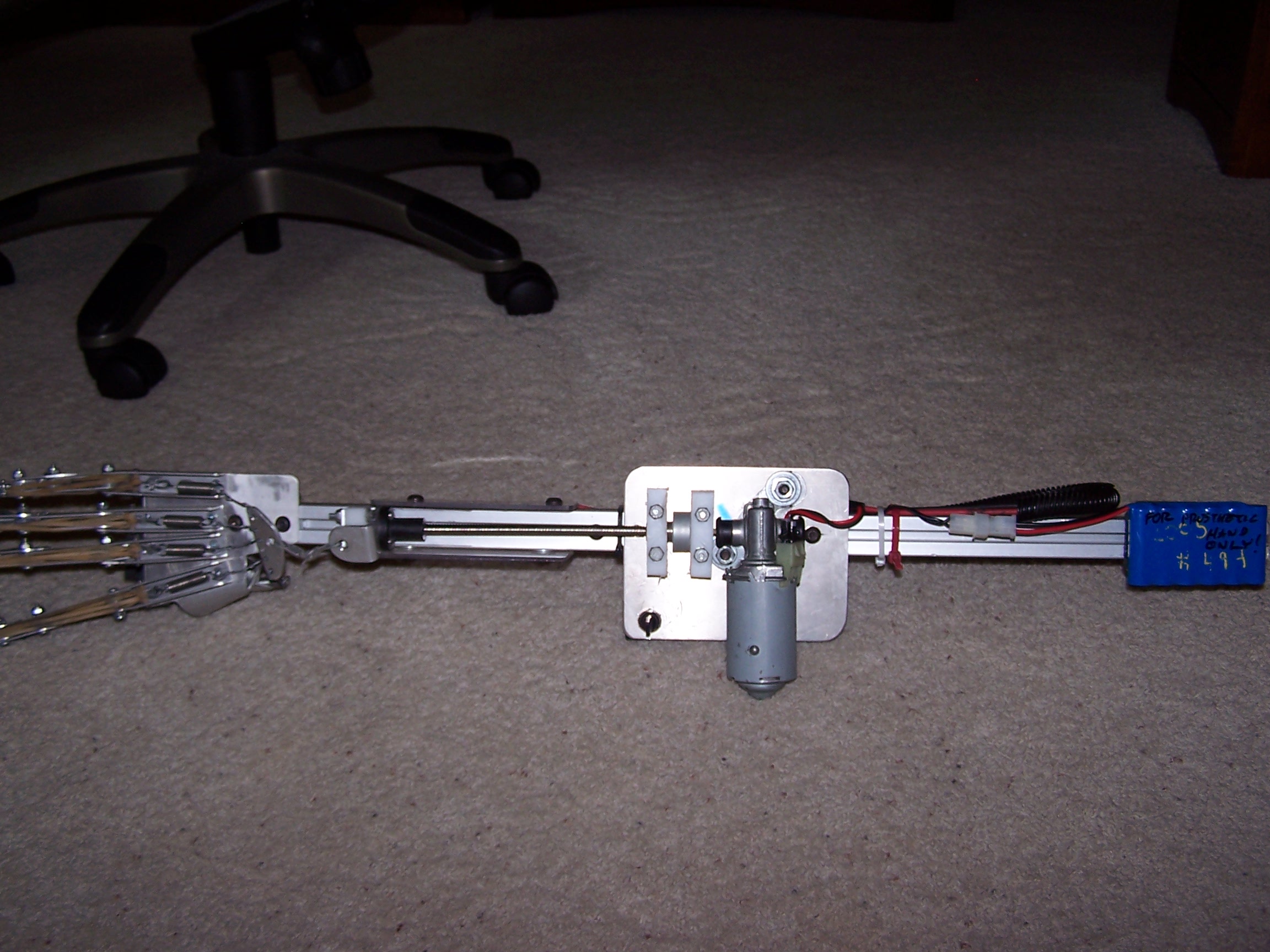

1326: Entire hand.

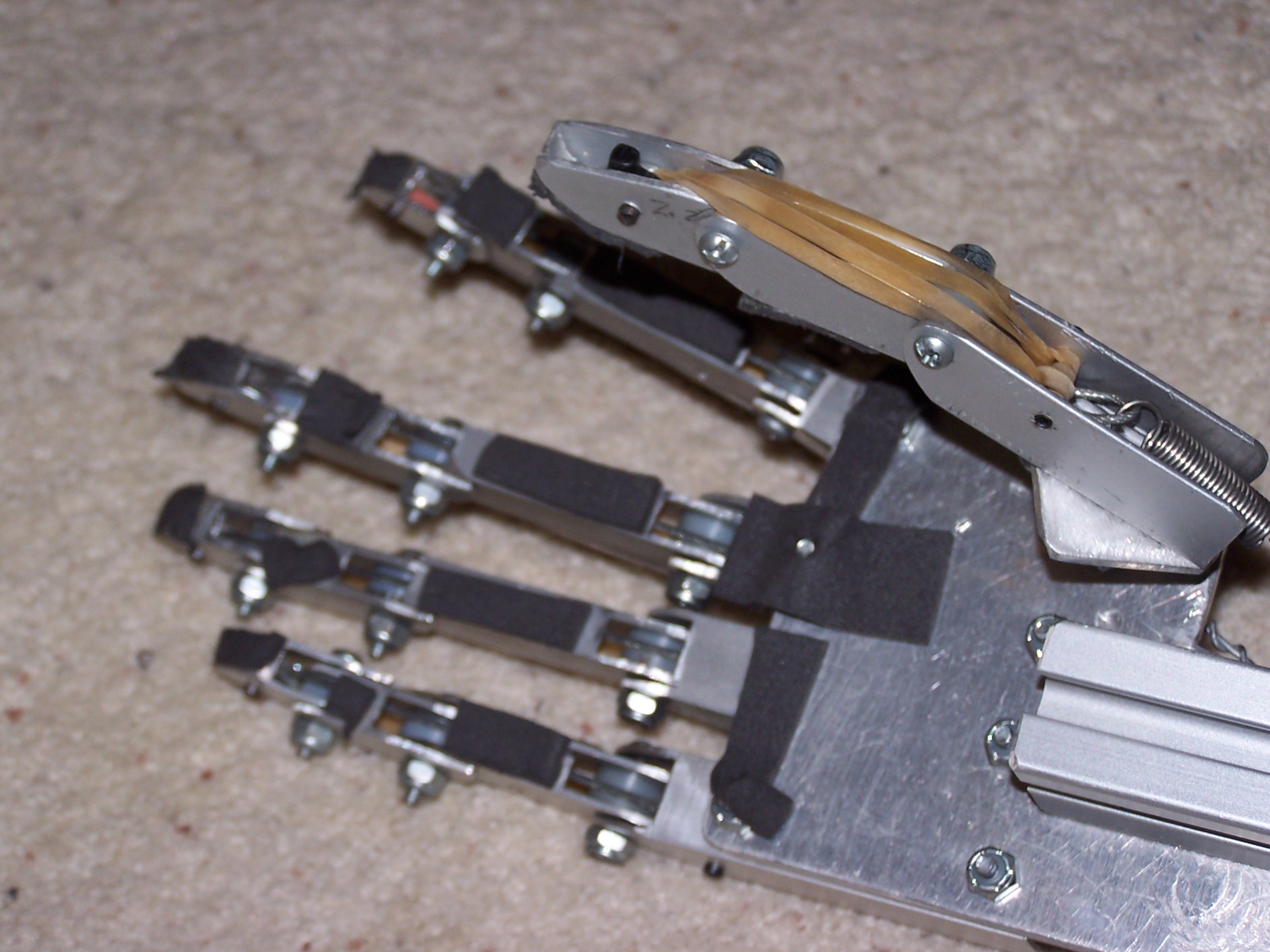

1327: Thumb and Inner hand shown. Black foam to help protect from rivets and bolts. Increases grip.
1328: Too large, but showed underside of arm. Unremarkable.
1329: Central cable connector. all fingers and thumb connect to this. I plan to replace this part and spiral gear with muscle wire or motor cables.
1330: End of fingers. Shows the Rubber bands end point. I plan to keep the rubber bands in place.
