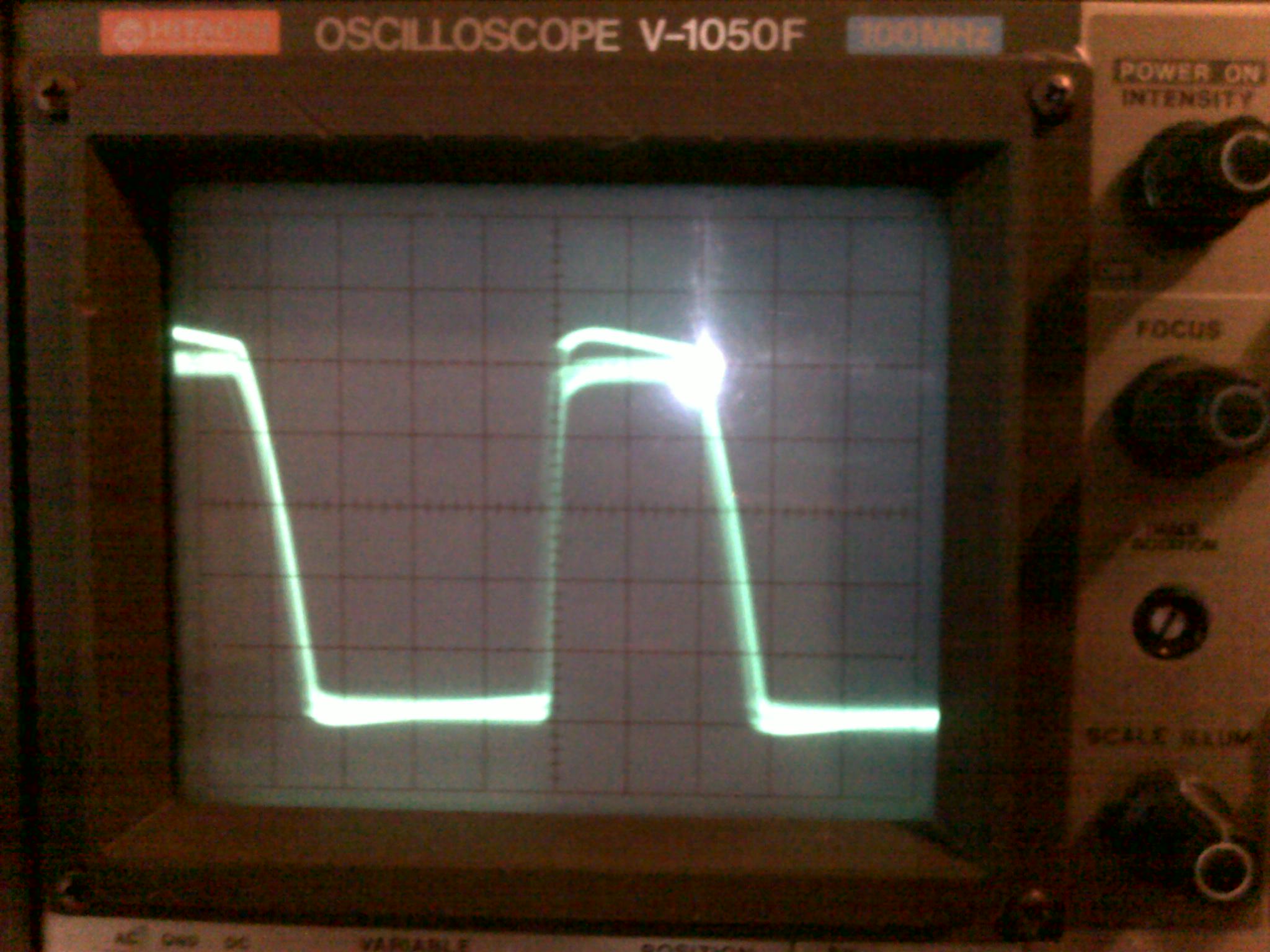

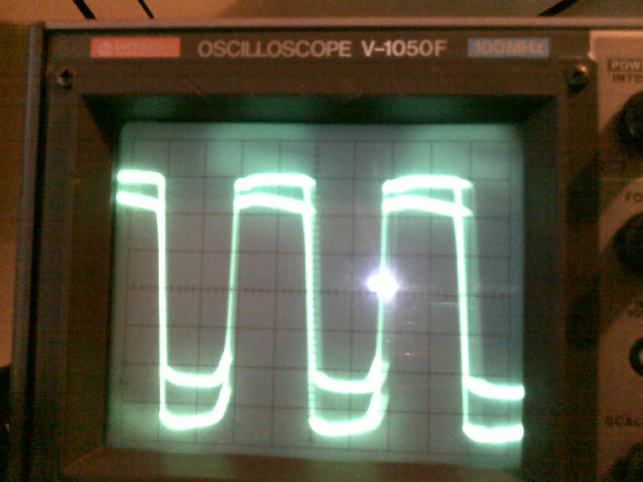

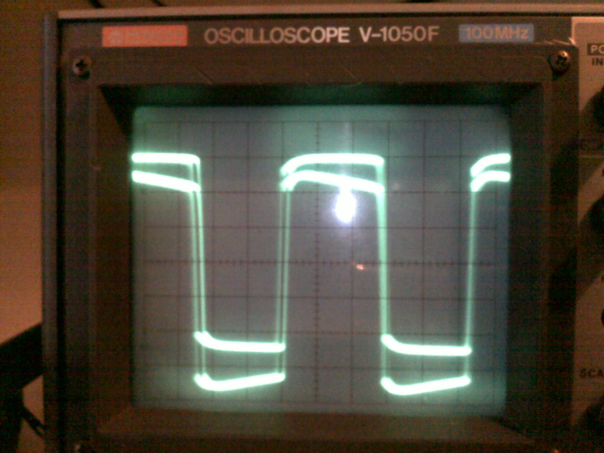

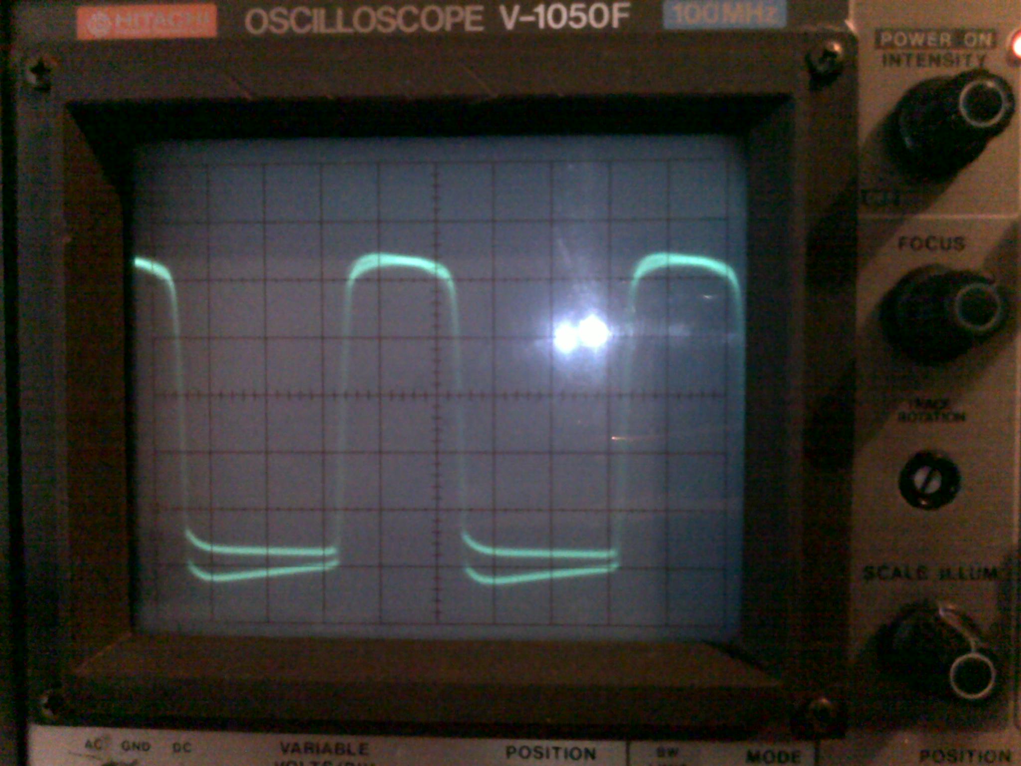

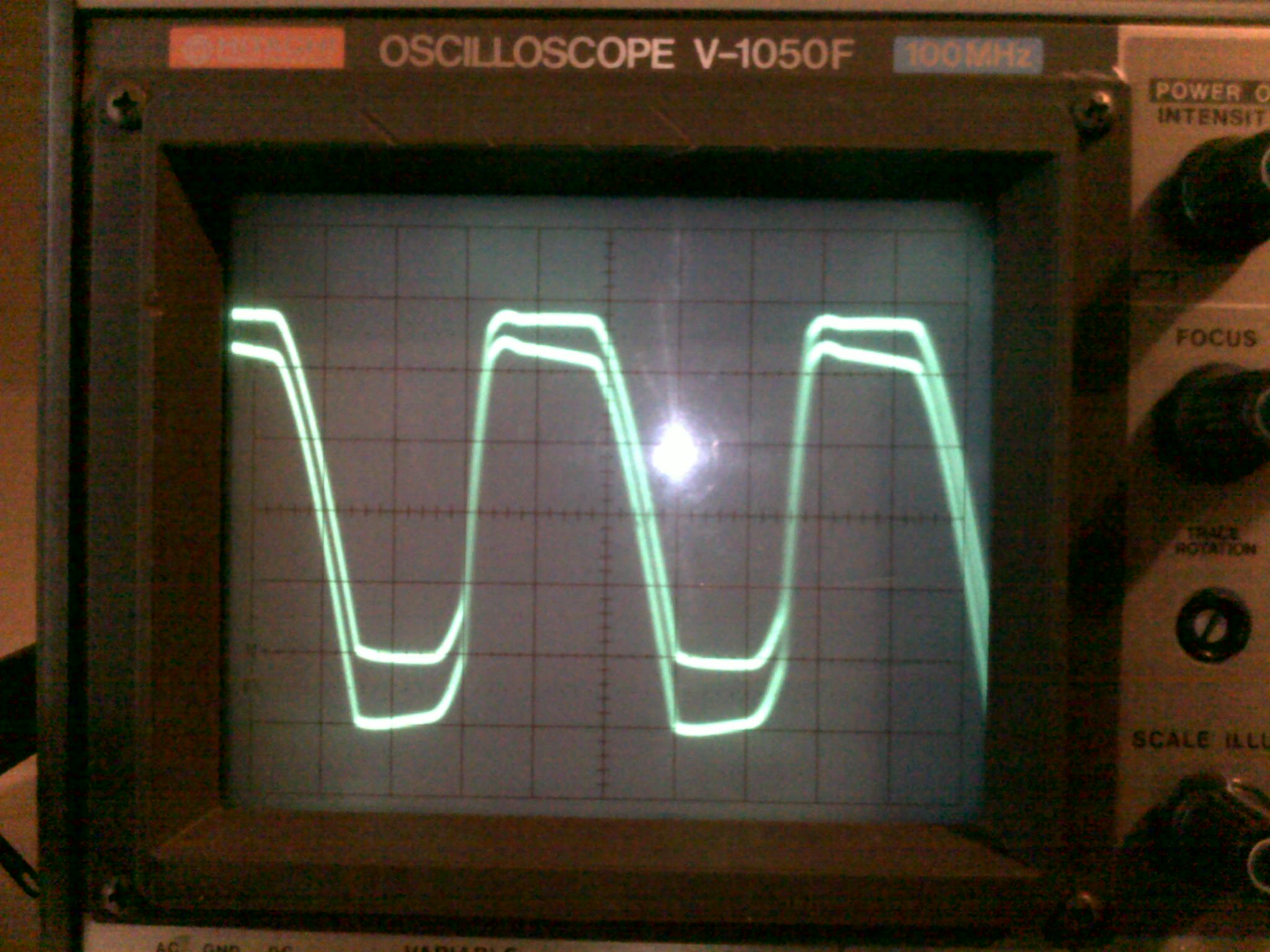

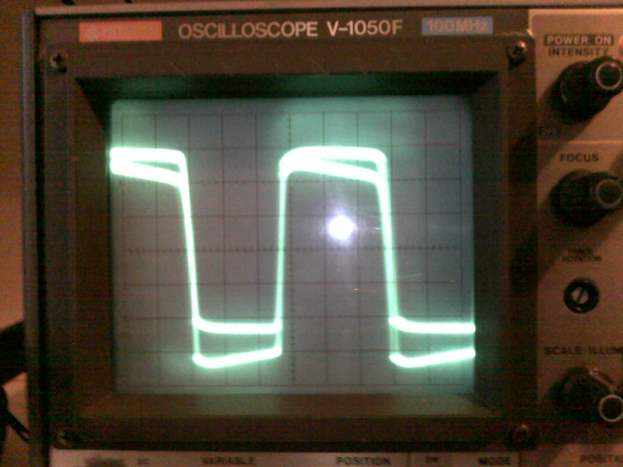

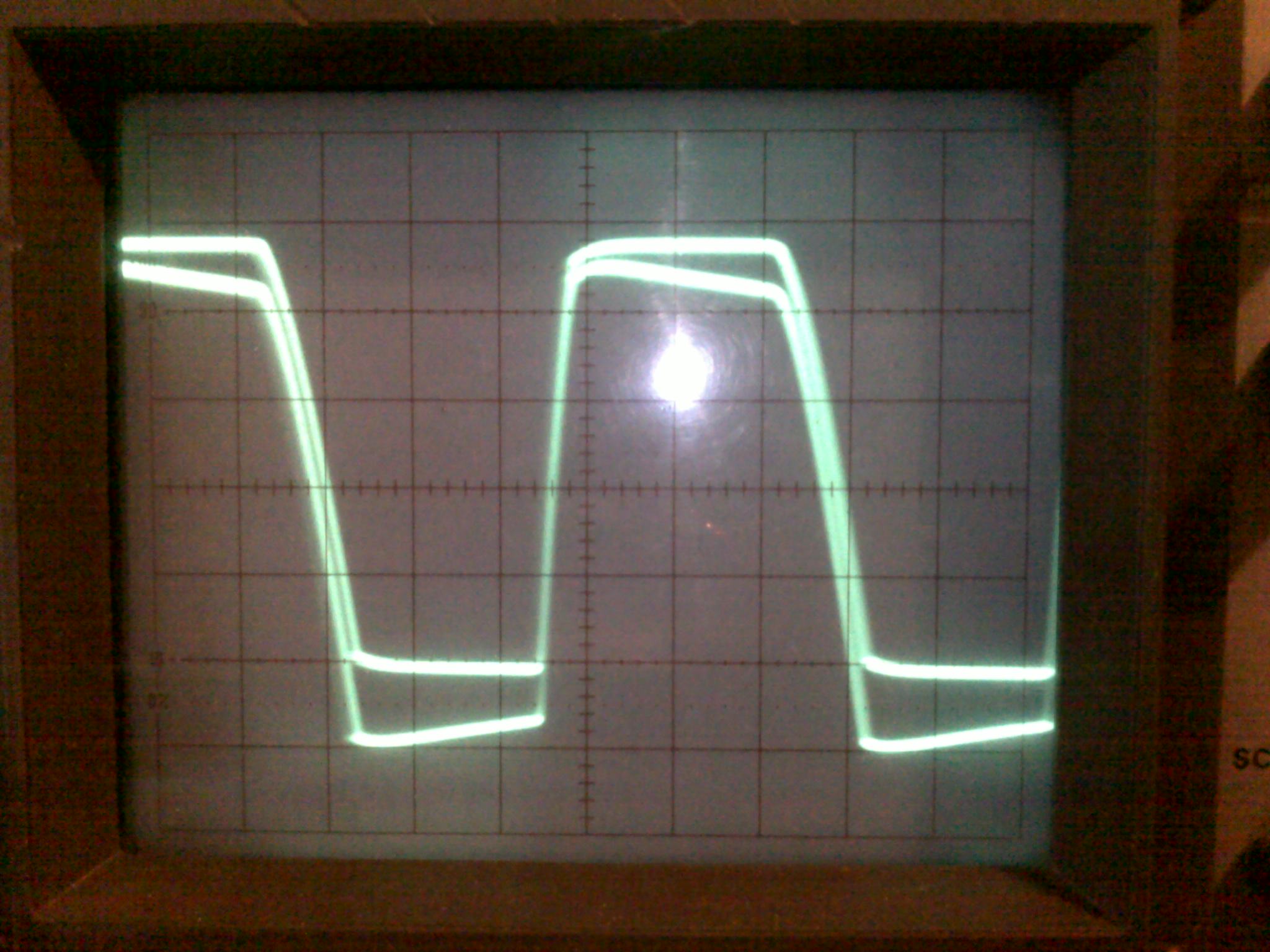

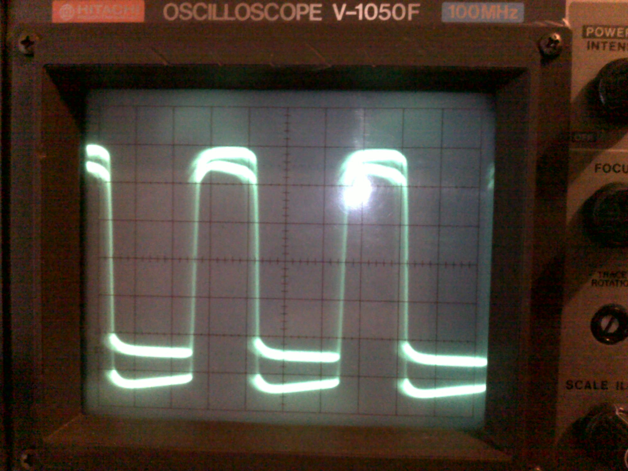

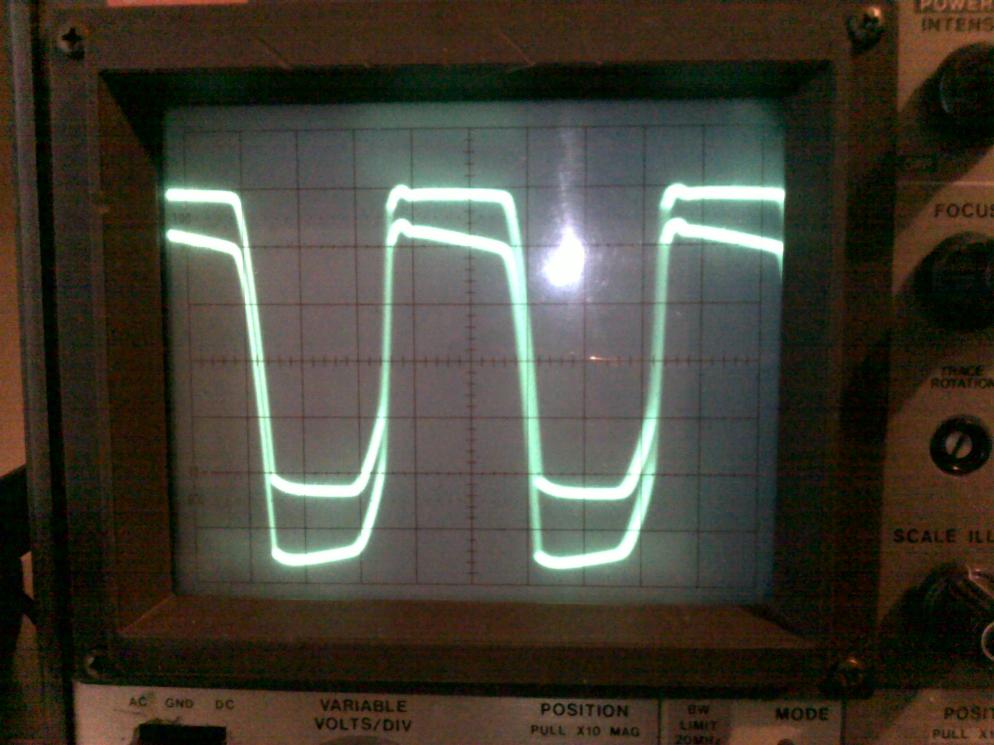

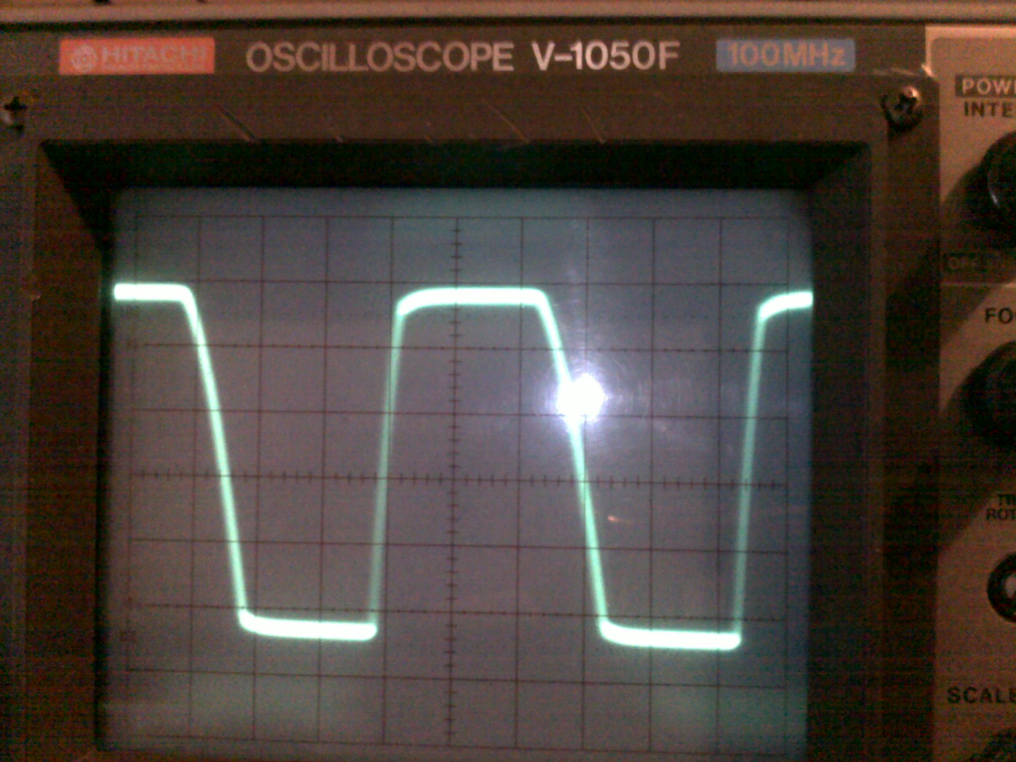

Here are the scope images; I took 3 series with 3 different transistors, which are a darlington BDX34C , a BD140 and a BC327-25
BDX34C with 60mA load (a power LED)
BDX34C with 100mA load (a 1,2W 12v bulb)
BDX34C with 300mA load (a 5W 12v bulb, limited to 300mA by the current limiter)
BDX34C with 200mA load (a 11AH battery + desulfator)
BD140 with 60mA load
BD140 with 100mA load
BD140 with 300mA load
BC327-25 with 60mA load
BC327-25 with 100mA load
BC327-25 with 300mA load
As you can see, there is a sort of "second waveform" superimposed with the first, and I had a lot of triggering problems to make them both appear in focus.
The strange thing is the frequency, I had to put the scope on the 0,5 uS range, and since the wavelength si roughly 3 divisions, I get the frequency is about:
1/0,0000015 = 666666Hz !!!
How can the frequency be so high????

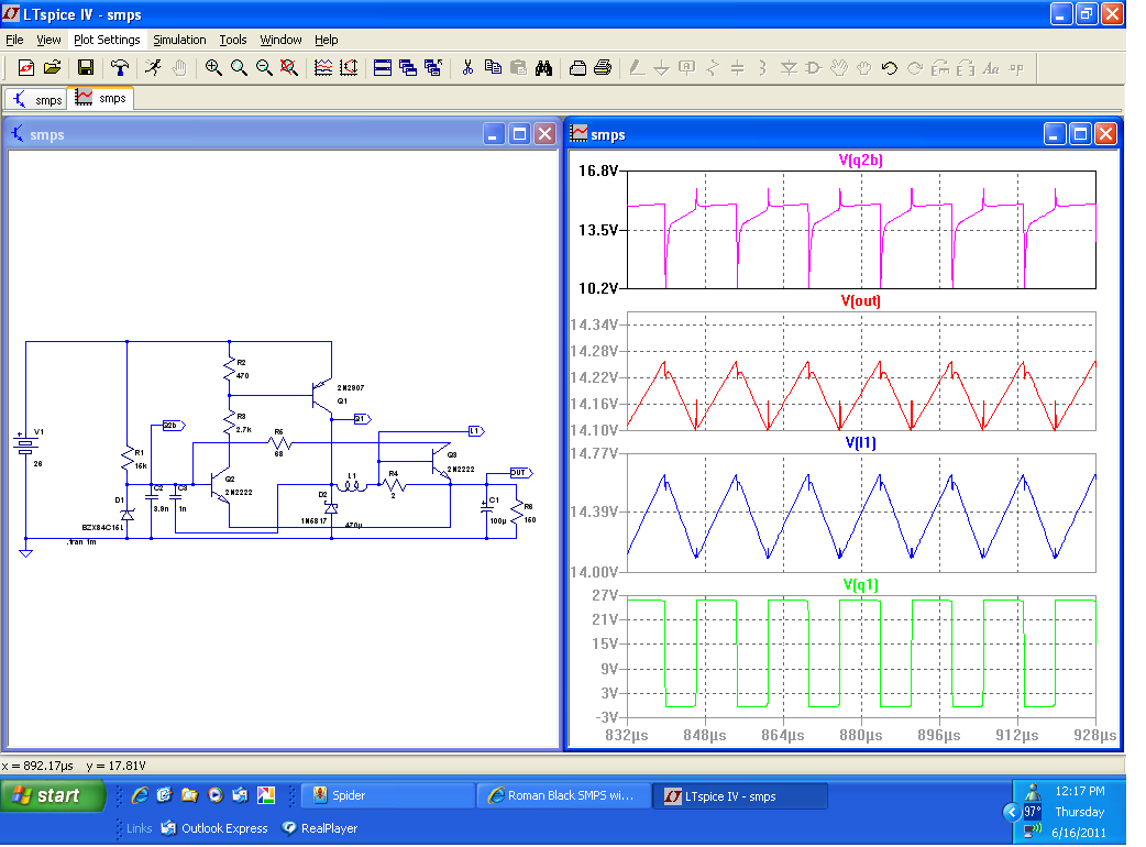

Here is a plot of the waveforms. Seems like your inductor should be OK.
Take a look at your waveform on a longer time scale to see if there are some pulses missing. Your "jitter" may be a clue.
If the inductor is saturating I would expect the triangle after L1 to look more like a square wave.
PS I didn't have the correct zener so the DC level may be off a little.
Wow! You just introduced me to LtSpice!
I tried to reproduce the circuit and , then noticed that I had the wrong resistor to polarize the zener (4,7K instead of 15K).
Guess it remained there after some tries and I forgot...
However by simulating the circuit with LtSpice I noticed that as the resistor value lowers, the frequency gets higher, and in fact with 15K i get the right , slower, frequencies.
I then tried it with my breadboard and the scope confirmed this behavior; also, with 300mA output the BC327 gets only lukewarm and doesn't smoke anymore.
Also, the scope shows the square wave is way more precise and "squared"!
By trying various values in LTSpice, I also understood the significance of the two capacitors that regulate the "on" and "off" periods.
I could even get the right operating frequency while keeping the "wrong" zener resistor (4,7K) and increasing by 5 fold both capacitors (22n and 4.7n).
I have to say LtSpice is a wonderful tool, I had never gotten around it since I had tried before its "cousins" (the various SPICE versions that are around), but never gotten to make them simulate anything useful.
LtSpice instead works like a charm!
Thank you ronv, you just opened a new world to me!
My best regards,
TheBlob
