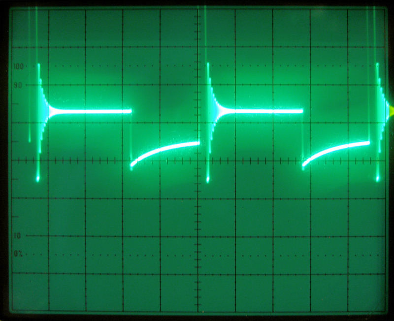

I photograph the scope images ocasionally using a digitalcam. Turn on the macro feature, set shutter priority to force 1/25 sec or faster - about the slowest useful handheld shutter time. Don't use flash. Consider taking another shot of the entire scope to capture all of the settings.
These don't usually need much post-procesing. The most I will do is correct barrel distortion common at close-up macro shots, perspective correction if I didn't hold the camera straight. Sometimes brightness and contrast. For posting I resize and increase the jpg compresion.
Extra credit - what might be causing this waveform and what is wrong with the circuit?

The positive-going part of the waveform has ringing then has a nice flat DC-coupled top. The negative-going sags back like it is capacitor-coupled. Weird.
The real photo looks a lot better than those black and white blobs.

Now that's the sort of picture we're talking about!.
It's called ringing, I wouldn't suggest a cause without knowing the circuit it came from!.

Extra Credit was just to see what people could come up with.
For those interested, I have been fiddling with boost converters recently. The photo is the voltage across an inductor being charged and discharged by a square waveform, into a Schottky diode and a 100uF cap - the circuit acting as a DC-DC boost converter. I am not sure what causes the ringing, and the output is not efficient - cannot get much current out of it. Probably poor selection of choke value, too much choke internal resistance.
I was using a PIC to generate a PWM waveform, connected to two Pots so I could dynamically vary the duty cycle and period. Also connected a variable voltage supply to the input to the choke.
I took other photos too, some showing no ringing - good square waves, others ringing like a bell.
