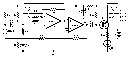

hi ,can any one please help me in explaining the room noise detector circuit and how each component is designed
i have attached the circuit diagram

Device purpose:
This circuit is intended to signal through a flashing LED, the exceeding of a fixed threshold in room noise, chosen from three fixed levels, namely 50, 70 & 85 dB. Two Op-amps provide the necessary circuit gain for sounds picked-up by a miniature electret microphone to drive a LED. With SW1 in the first position the circuit is off. Second, third and fourth positions power the circuit and set the input sensitivity threshold to 85, 70 & 50 dB respectively.
Current drawing is <1mA with LED off and 12-15mA when the LED is steady on.

Hi Vibish,
As I said on the other website, I don't think the circuit works properly:
1) It is missing a diode across R12 to discharge C4 when the signal charges it through the base-emitter junction of the transistor.
2) I think the circuit needs a peak detector circuit.
It is a simple circuit and I explained how it works on the other website.

hi friends i have a circuit of room noise detector available at net that is not working c4 should have a discharge path what is the diode should be placed and where///???/ please help me please

1) It has two opamps used for a mic preamp.
2) The preamp has adjustable gain set with a switch.
3) It has a transistor that is normally turned off and when the signal is high enough it turns on and lights the LED.
