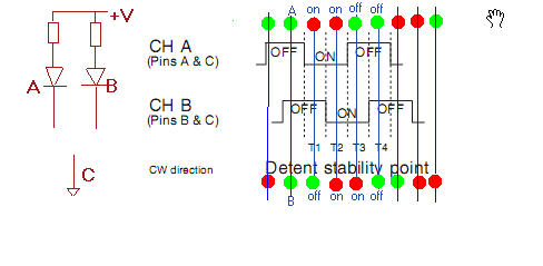

Have you a sketch showing how you have wired the encoder.?
Using a 5v supply, you MUST use a series resistor to limit the current thru the LED and switch contacts!
EDIT: look at this image

Eric, I see the diagram you posted. My setup is just like that minus the resistors.

Have you looked at that image I posted.?
The switching pattern of the encoder is taken from the datasheet of the type you have posted. I added the small diagram how it should be connected.
Is your circuit the same as the image, also be sure that you have correctly identified the 'C' pin.

Look at this image to see the sequence you should observe.
The design of the quadrature signal phasing is so that its possible to determine which way the shaft is being turned and by how many indentations. [steps]
Quadrature of the two signals means they are shifted in phase by 90deg relative to each other.
The 'detent' stability points on the signals are where the mechanical indents in the switch mechanism are located,, ie: at rest.
A point to remember is that if switch contacts are subject to switching currents higher than the maximum rated value the contacts can be damaged.
This damage will cause intermittent closures creating multiple signals to the external equipment.

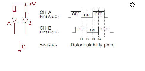

Been doing a little checking thru various encoder types.
You may have this type:
Contacting encoders often have detents that 'click' through an entire A/B cycle per detent
That is the mechanical indent is positioned to give only a transient switching action.
I found this link that may help.

EDIT:
Relooking at your original datasheet, its misleading, it shows the detent numbers misaligned which suggests the A/B cycle is at rest.

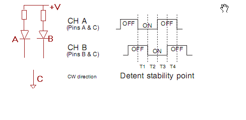

Modified image.

You have to debounce it he seeing switch bounce
Contact bounce would be if my MCU saw several hits. This isn't the case as I havn't made it that far yet. I just built a VERY simple test circuit that lights an LED through a 390 ohm resitor. Each phase (A & B) has it's own LED.
I'm seeing both LEDs light up but only as I move from on detent location to the next. They turn off once I reach the resting point. One phase always lights up before the other, based on the direction of rotation.
EDIT:
Modified image.
That is a great find, but I still don't think it accounts for what I'm seeing... :(
If I had this other type of encoder, I'd see various states as I rotate. But what I see now with my current configuration is consistent with each rotation.
