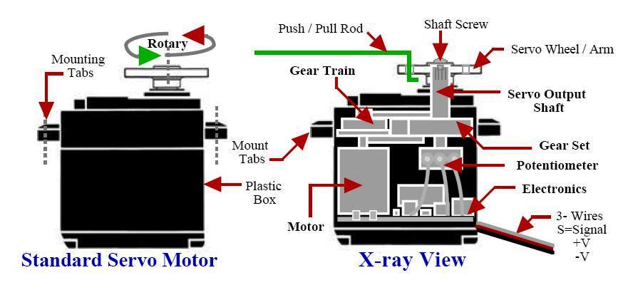

"There is also slop in the gears." Slop does not come into it.
Despite that comment being six months late, it is not accurate.
The TS is asking about accurate positioning. Gear slop is a little like backlash in a machine tool's positioning controls, like in a vertical mill. Backlash can be compensated for to an extent by always approaching the final position from the same direction, for example, pulling the table toward you or pushing to the right, but that does not completely remove its effect. That type of compensation is rarely, if ever, done with these light-weight, inexpensive servos. Yet it is certainly a concern when accurate positioning is needed. Also, the potential for the orientation of the servo relative to gravity or other forces (e.g., aerodynamic forces on a control surface) can change, which adds slop-related error that cannot be compensated for in the manner described for machine tools. Any movement due to such slop is not detected by the feedback.
John
"Despite that comment being six months late, it is not accurate. "
The pot is connected directly to the output shaft. Slop does not come into it.
Not trying to start anything, you all just got me to wondering, how does the pot connect to the shaft? I never pulled a servo apart as they use to cost a lot of money back when I played with RC cars.
