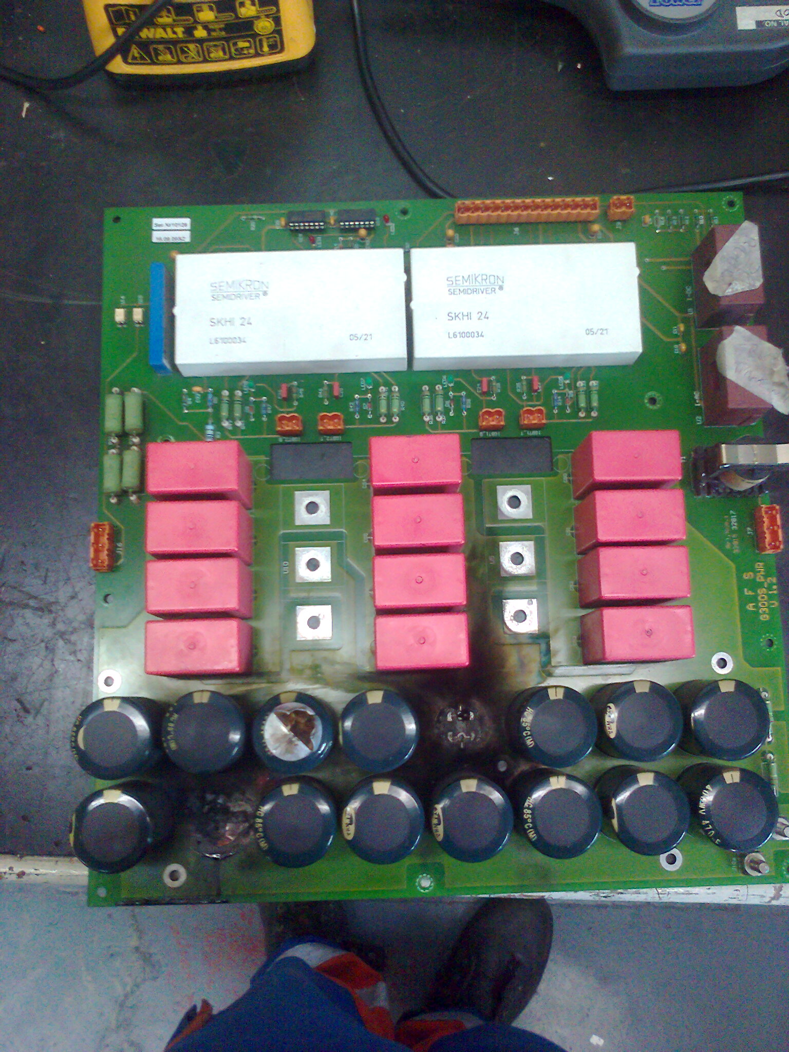

Seems the old machine is having a hard time, one of the elctrodes got damaged and shorted to ground and this happened:
Looking at those capacitors, they all seem to be "bulging" on the ends. Not a healthy sign.
2 of them have exploded and vaporized the copper tracks, this pcb was repaired by my electronics supplier a year ago, I wonder if they fitted caps with too high a esr.
I'm not going to tell the boss that.
