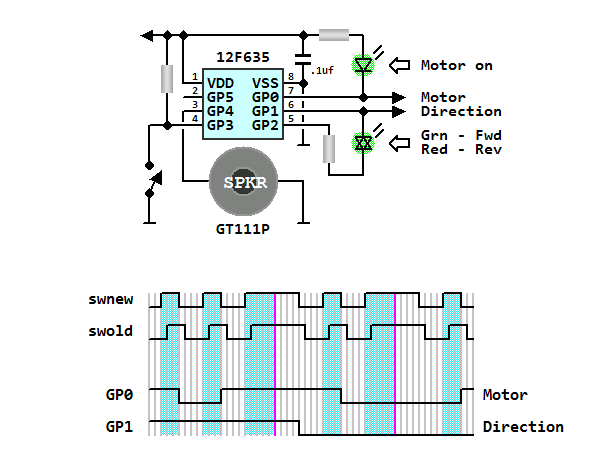

May I ask what's the purpose of this device?
:) You can and I'll tell you :
It's to start / stop and reverse (when required), the direction of H-bridge logic controlled motor, on a piece of lab equipment.
The catch is, this all has to be done using just a simple SPST push-button switch.... :eek:
Cheers
What you posted don't add up to that have fun learning to write code I'm not writing the whole thing in basic just some samples but to let you Know there is no free basic compiler for 12f508
Great Cow Basic or GCBasic will work with12f508 and other baseline PICS, including the 10F's. Have to be careful with the 12C, 16C series though, because no one hardly uses them anymore and therefore not always tested.
Thank you for the explanation . Would that application require additional logic, for example, would you stop the motor before changing direction?
Would you consider a "short" and "long" dual-switch function instead? Here's how it works. You press the switch and get a short beep as feedback. If you release the switch before one second you'll toggle the "short" press output from off-to-on or from on-to-off. If you press the switch and hold it pressed until you hear the double-beep feedback at one second and then release it you'll toggle the "long" press output from off-to-on or from on-to-off. You might use the "short" press output for motor on/off and the "long" press output for direction. You can also add the logic to ignore a "long" press to change direction if the motor is on.
In the diagram below you'll notice we use a switch state latch or memory (swold) which allows us to easily detect a "new press" or a "new release" while ignoring the other switch states. We sample the switch at 32-msec intervals to debounce it. On a "new press" we start a 1-second timer (the blue sections) and task a single beep for user feedback. On a 1-second timeout (the red vertical lines) we task a double beep for feedback. On a "new release" we check to see if the timer has timed out and then toggle the appropriate "short" or "long" press output. Please note that the diagram assumes we've added logic to prevent changing direction if the motor is running (active low).
Regards, Mike

A huge thanks Mike - you've obviously put a lot of time into this.
I don't think the 'long press' to select reverse is actually a good idea... Why ? - because when a person naturally wants to perform a definative action (in this case, stop a wildy-spinning motor), they are more likely to hold the button down for a much longer period of time, in order to stop it.
This is illogical to you & I, because we know the processes involved & the switching timing, but not to the layman.
Is the 1st code listing you posted in Picbasic ? - I get lots of errors when I try to compile it in any of the 'freebie' basic compliers I have. :confused:
Unfortunatly, the same with 2nd assembler listing - I attempted to compile this with MPASM - but just got of 'not defined' errors...
In saying that, I'd love to give your code a try - would any changes be needed to use a 12F509 ? - no 635's anywhere !
Please forgive my total & utter ignorance :eek:
The first code snippet is pseudo C code. The second code snippet is assembler but you shouldn't expect it to compile until you add missing pieces like variable declarations, an init' section, the delay macro, etc.
No promises but I'll try to come up with something for 12F509 when I get a chance.
Mike
"the first code snippet is pseudo C".... Yes, that certainly explains the problems encountered using a PICbasic compiler ! :D
Did think the assembler code looked a bit 'out of character' from the few asm listings I have looked at -- seem to remember there's usually quite a bit of text & code before the actual routine itself starts....
Cheers Mike :)
