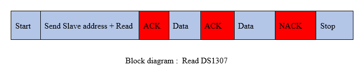

I don't understand in programming how to read DS1307. MCU 8051
This is my understanding to read DS1307
Basic steps
Start condition
7 Bit slave address + Read operation
After sending the 8 bits (7 address +R/W) the master generate Acknowledge
Slave ACKs indicate it got the data and the master can continue
Master Send Register address
After sending the register address master generate Acknowledge
Master Send Data
After sending Data master generate Acknowledge
Slave NAKs indicate it wants no more data.
Stop Condition
I need routines to generate Start, Re Start, Stop conditions, read I2C, write I2C, check ACK or NAK and generate ACK or NAK.

Now I am looking help to make two routines
I2CSend(unsigned char Data)
Read_DS1307(void)
How to make these two routines ?

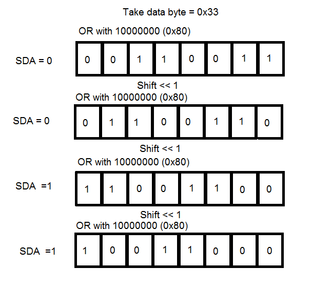

What is 0x80 ? what is purpose of this hex value ?
0x80 hex = 1000 0000 binary
When shifting its much easier to test the MSBit... if (your_byte & 0x80) <- test if the SDA line is high or low.. Remember you are shifting the highest bit out first, then rotating all bits out along the serial wire..
Can I implement with my routine ? later I will work with your routine? what do you think ?
Why there is only 0x80 ? any special reason ?
