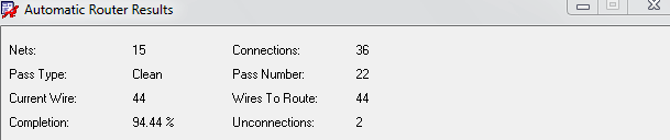

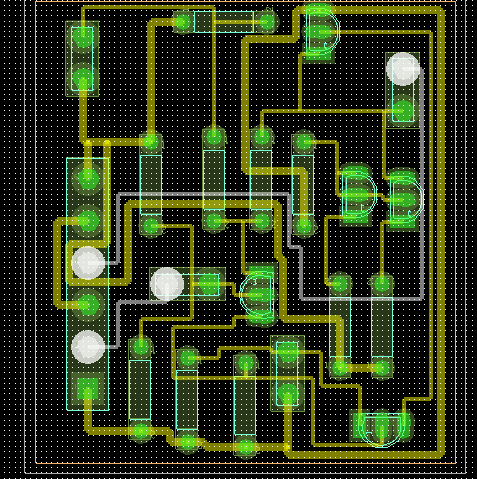

Hello,
As the title states, im having some problems with ORCAD PCB editor. When I rout the curcuit, everything looks like it has been routed propperly, all the connections made. But in the resaults it says there are two "unconnections", and that it is only 94% complete. Normaly the errors would be marked with red on the curcuit, but in my case it isnt. So I've tried spacing everything out, to see if that helps, but unfortionatly it doesnt.
Has anyone encountered simuler problems, or know what could be wrong?

Have you checked the ratnest to see where the 2 problems are? I've had the same problems in the past, but getting into the habit of running the trace all the way to the connect point on the pad eliminated that issue. That might be your problem, but ratnest it and see if editing the disconnected traces shown fixes it.
Thanks for the help :) I found the problem. The autorouting wasnt able to place one wire. So it decided not to do anything about it, and I'm guessing it thought I wouldnt notice. One would have thought if a program cost $10 000 there wouldnt be bugs in it :D
Well good! But remember to toggle the ratsnest to locate any unconnected nets when either using autoroute or hand routing. I only use autorouting for final component placement, then delete the traces and hand route. I just don't like all the vias and orthogonal trace routing like your board above shows, but that is just my preference.
I don't really have that much experience making PCB's, so I find it easier to place componants where I want them, and use the autorouting function. If you don't like the sharp corners, you can use the "gloss" function, which trys to make the 90 degree corners to 45 degree corners.
