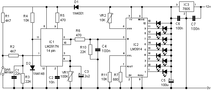

need a circuit diagram for led rpm indicator using LM3914 and LM2917\LM2907,...
help me anybody...plzzz....sorry 4 broken english..

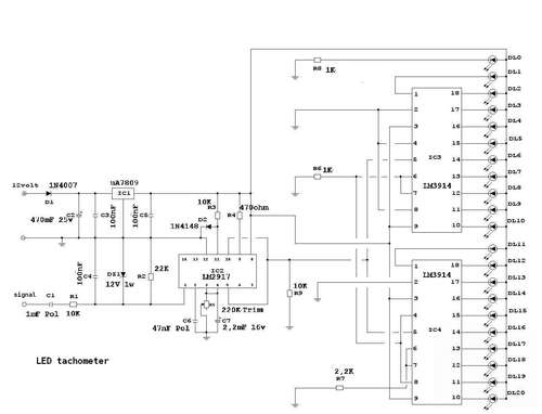

i want to use this circuit for bike 1 cylinder and i don't know what frequency to use.voltage supply for the bike is 12V. here I attach the circuit I built I had tried and failed. and I ask your good offices to help me identify the problem circuit.
  • Step 1Building the circuit.doc
I looked at the drawing you posted. I followed the link and printed the Word document. I can't make out the drawing. It is like fuzzy and out of focus. What I could make out looks pretty straight forward. I just can't focus enough to read the damn thing. Sorry. Maybe someone else will come along that can read the schematic and see it better than I can.
What part of what you have built does not work? Does the F to V work? You should be able to troubleshoot that wioth a meter.
Ron
I can't read it either, and it is very fuzzy, but I can see it well enough to tell you that the chips (other than the voltage regulator) are 2 LM3914s and one LM2917, if that helps.
Oh, but the title of the thread already tells us that. Doh! Never mind ...
Well at least I know it isn't just my vision. I printed the stuff and still can't really read it well. :)
Ron
F to V to function properly but the LM3914 is a problem. I did not get the reading. I hope if you are in for other circuit to work properly, maybe you can show me. I'm almost out of time to this project.'s Head was dizzy . lol!
I don't know how you managed to get that image into Word, but all I know is that's the worst way to try to convey graphic information. Please try to post a readable version of the schematic so we can actually see it. That should help some of the experts here diagnose your problem.
apologize for this inconvenience. I have been searching the internet, can I use this circuit for the engine 1 slinder? This circuit is suitable and right for my use? so, thank you.
