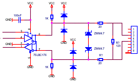

I always use this configuration, work well with cheap CAT5 UTP cable upto 400m. The 120ohm need for cable end, value depend from cable impedance.

how do you config the pic? i mean
wich speed do you use? do u use inverterd or true mode?
for example 9600,8,n,1 ???
