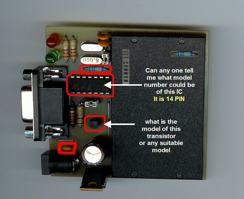

This is a Card Reader Phoneix
will u tell me what could be the number of there IC

what exactly are u asking for ?? if you want to know what is the ic, its a max232 as far as i know.
It is unlikely to be MAX232 as this IC needs four external electrolytic capacitors to work and the capacitors are not visible in the image. I would guess the IC is a microcontroller, based on the two crystals, 330 ohms resistors, and the two LEDs near it.
Are you trying to repair it? If you want to build it, you're in for a big surprise.
There are also two crystals on the board, one is 6.000MHz and the frequency of the other not readable from the image.
You can buy these crystals no problem, but the presence of crystals indicate hiding somewhere there is/are microcontroller(s) or custom made IC which you cannot obtain or obtainable but won't work without firmware code .

look .. Ths circuit used to read smarcard of ateillites and Known as Phoenix Programer ..
Look .. after searching i guess is 74HC04
Look ..i measured it i found that Vcc and Gnd is same as its datasheet
but i need to ask .. Can this chip be an interface for serial port
also i found that pin 5 is inverted with 6
pin 8 is inverted with 9
pin 10 is inverted with 11
Thank u for u help

where did this card reader thing come from? it looks like a prototype or hand made, deff not mass produced, who uses that many TH components
heh, i type phoenix smouse into google and I get lots of info for hacking satellite receivers ...
so, my guess is it's a pic micro, since smartcards are PIC based, this board is most likely just a 'smart' PIC programmer (ICSP) with a smartcard socket
there aren't too many current model 14 pin PIC's out there, and the pin-outs are pretty much the same across all of 'em, just different features and amounts of memory ... if I had to hazard another guess, I'd go with a 16F630
but whatever is on there is likely code protected, so its not like you'll be able to duplicate the firmware to a new chip or anything
hmm ... all those have the 232 level shifter and its giveaway charge pump capacitors
but the board in the orig. picture has no caps, not even 1uf ceramic which could have been hiding on the solder side!
maybe it's a MAX233, which is the max232 but with internal capacitors? ... no, the 233 is 20 pins
from what Bill posted, sure looks like I guessed wrong with my stab that it's a pic chip ;)
The PIC is probably hiding under the black plastic in the form of a black blob.
OP already told us the power pins of the visible 14-pin DIP is 7 and 14 so it is unlikely to be a PIC. It could well be a 74HC04 used as oscillator for the 3.579545 MHz crystal.

It's only a single sided PCB, so there can't be a COB chip under the card reader.
As suggested it's probably just a TTL buffer, and it may well be designed to connect to a PARALLEL port and not a serial one? - a suitable lead will have been provided with it.
I got it. The PIC is under the black plastic but on the inserted card.
The components are supporting chips act as signal source or buffer. I still think it is a simple serial port interface using resistors and transistors.

Sorry, I didn't realise you didn't know that there is a PIC on the inserted card?, which is the complete reason for the programmer :lol:
Many of the cards also have an EEPROM on them as well, but there's no external access to it, you have to program the PIC to transfer data to the EEPROM.
BTW, you might be interested to know that the May 2006 issue of EPE has a card reader/writer as a project, it uses a MAX232 and TWO 7407's, and connects to the serial port.

i want only to say some point ...
there is no PIC under the black box ..it is very thin ..and i use it just insert a card in it
i thought it may be a max 232 ..but it is 14 pin not 16 ..and no capicotrs ,,,so i thought it may be 233 ..but it is 20 pin
Pin 7 is connected to ground all time
Pin 14 is connected to Vcc all time 5V ( most likly to be TTL )
i made some test ..by setting pin 1 to Vcc .. i found pin 2 is grounded ..also i set pin 1 to groung i found pin 2 is Vcc ( inverted pins)
same happen with pair ( 3 - 4 ) ( 5 - 6 ) ( 8 - 9 ) ( 10 - 11 ) ( 12 - 13 )
and i think it is most likly to be 74HC04 ... to be also good with high sped with 3.5 , 6 Hz crystals
I want u please to confirm about my conclusion if works or not
may u also think about what the transistor model be ..or npn ..or pnp
Thank u svery much
