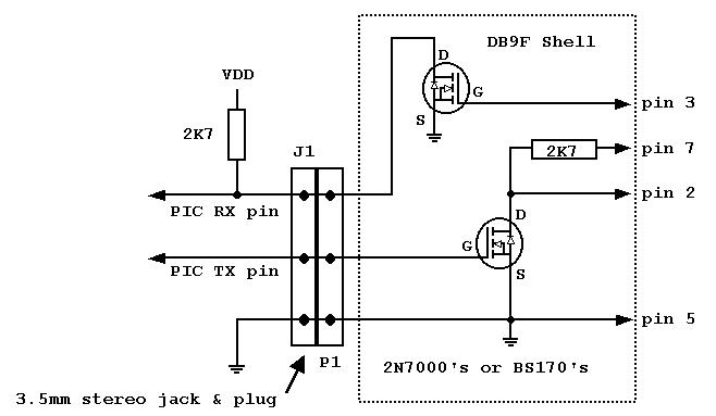

I'm thinking about using transistors (2N3904) in my application for level shifting the RS232 signals instead of using a MAX232. Much the same way a BASIC Stamp does it.
Is either one inherently more power hungry than the other? Can the transistor method be made to consume less power than a MAX232?
The reason for considering this is cost and my PIC application will most likely be run at 3V. And I also want to have a choice of two serial connections to it: 1) TTL level signals from another PIC or a GPS, and 2) my PC or laptop.

Mike,
You might consider using a pair of 2N7000 or BS170 MOSFETs... They use practically no power and work extremely well with those otherwise troublesome low-voltage PC/Laptop ports... They're also open-drain and will "pull-up" to whatever voltage you want (within reason, grin)...
Here's the circuit I use -- two 2N7000's and two resistors... I've used it without problem on many different PCs and laptops with baud rates up to 115,200 baud... While the circuit as drawn shows a resistor on the PIC board and two transistors and a resistor built into a DB9F shell with 3.5mm stereo plug and jack connections, all four components can easily be installed on the PIC board along with a DB9F connector...
Regards, Mike

Hi Mike,
Yes, you need the "pull up" connection to pin 7 (or pin 4) on the DB9 connector... This pulls up the open drain output to the positive RS-232 signal level (anywhere from 5 or 6 volts to 12 volts, depending on the PC UART)...
Good luck... Regards, Mike

BTW, if you disconnect that 2K7 resistor from pin 7 on the DB9F connector and connect it to VDD (3v or 5v), you have your 3v or 5v TTL level connection to another PIC or the GPS...
Best regards, Mike

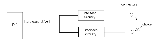

Thanks Oz. I have one of those auto shutdown devices, a MAX3221. My problem is that I wanted to have all the interface circuitry on the PIC board and have two separate serial connections using the same UART port, one connector for the PC and one for another PIC.
But having a MAX device on the board would keep it active even when data was being sent out the other serial connection, because the lines would be active. The great thing about the MOSFET solution is that no power will be used if that MOSFET isn't connected to the PC.
Mike

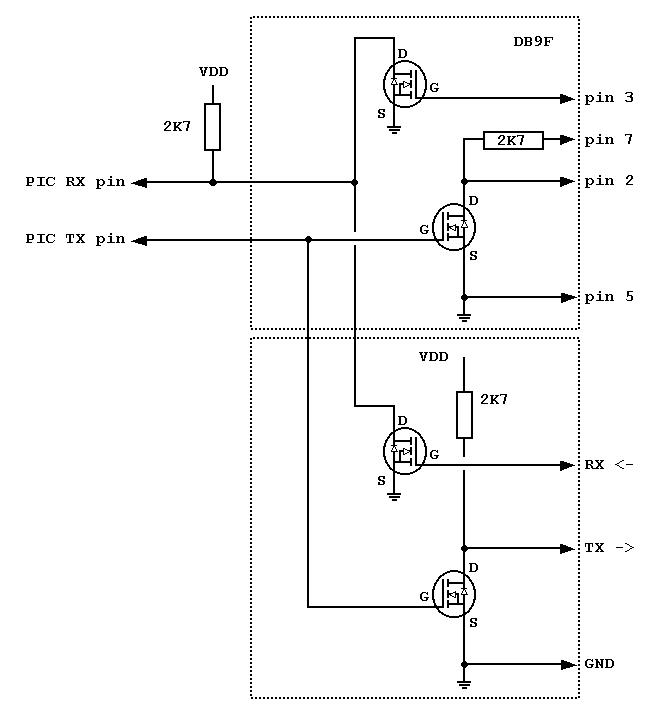

I tried this way with my PC and it worked. Would using this with a PIC require another inverter stage?
You could wire up the PICs to each other directly but if you want that dual port capability you'll want to use that 2 transistor convertor on each PIC... The 2N7000 drains can be connected together "wired-OR" as shown below on the PIC board with the dual ports...
So is this kinda what you're lookin' for? Top circuit for RS-232 levels and the bottom circuit for TTL levels... Duplicate the bottom circuit on the other PIC... Choice of one or the other interface on the dual port board but not both...
Regards, Mike

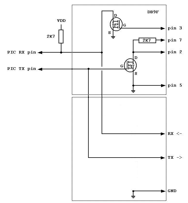

Yes Sir... That will work too...
<added>
As long as you're connecting 'direct' to the other PIC (no inverting/level shifting circuitry on the other PIC)... And you'll "cross-over" the signals between PICs (TX to RX and RX to TX between PIC boards)...
Have fun... Regards, Mike
Mike,
I just realized you could get away with installing a single 3.5mm stereo jack on your PIC board and simply plug in the TTL-232 convertor cable (with the circuitry inside the DB9 shell) to connect to the PC or plug in a straight through 3.5mm male to 3.5mm male molded cable to connect to the other PIC board... The other PIC board would have it's 3.5mm jack wired with the TX and RX signals reversed... Gosh, you could get away with a very nice clean design...
Here's a picture of one of my boards with a 3.5mm stereo jack installed for the RS-232 connection and one of those TTL-232 convertors...
Regards, Mike

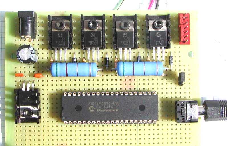

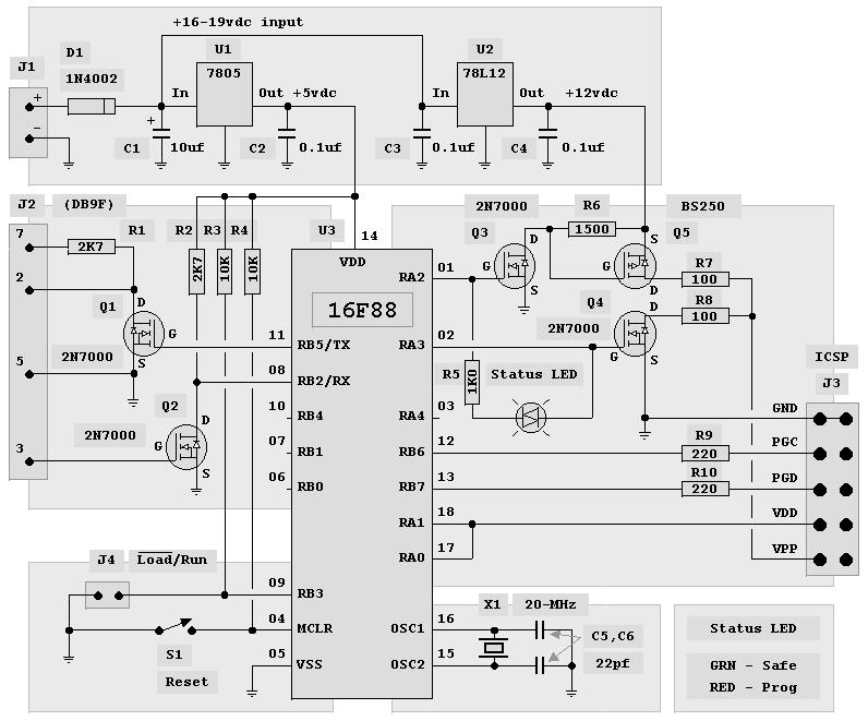

Mike,
Those little TTL-232 convertors in a DB9 shell are so handy I use them on many projects... Here's a Unipolor Stepper Motor test board I put together in March... Adding RS-232 capability to the board was simply a matter of installing a 3.5mm stereo jack and a resistor on the board --- and connecting the board to the PC using a TTL-232 cable...
Regards, Mike
