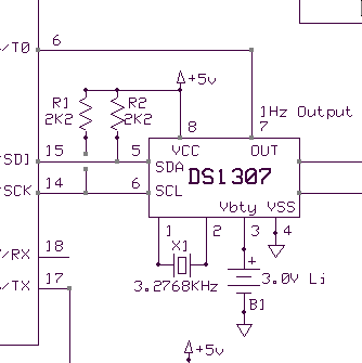

The X2 pin should only be left disconnected IF you are using an external 38KHz source to drive X1, else the 38KHz crystal should be across X1 and X2.
How is the DS1307 connected to the PIC pins.??

The RTC is connected with Atmega8 using I2C bus. I have grounded the crystal but still i get some noise and times to time it gets all wacky specially when my relays tick tack.
My grounding the crystal may not be that good i will check it again. Other that that if i disconnect he RTC my uC works smooth no matter how many time i turn on off the relays.
I see the external source means not a crystal.
The RTC is connected with Atmega8 using I2C bus. I have grounded the crystal but still i get some noise and my times gets all wacky time to time specially when my relays tick tack.
Do you have the pull up resistor on the DS1307 SCA and SCL pins.?
Also is your MCU well decoupled on the power lines.?
Yes i have 4k7 in the both SCA SLC.
Did not connected a decouple capacitor forgot about it. I will put a 0.1uf across the power pins of RTC.
