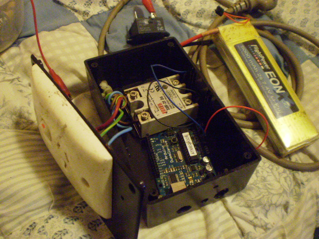

I have my pool pump on off peak. It only comes on during low demand times but left on it goes much more than I need .
Can the forum members suggest ways to build in a timer so that regardless when it turns on it only runs for 3 hours , once a day or at least once per switch on for 3 hours .
Naturally a normal power timer only runs when the power is on so they are unsuitable .

I need something that senses when off-peak is switched on and runs then for 3 hours and then does not turn on again until the next day

I'm starting to think an arduino setup to sense when on and maintain its own timer.

You want this pump to run for 3 hours max/per day, on off-peak hours, right?
I'm a fan of doing things with discrete components, but I think this calls for a custom-programmed MCU instead. It will need a real-time clock to determine 24-hr intervals, plus a counter to accumulate 3 hrs of off-peak time within a 24-hr interval. If the MCU is powered via the off-peak power-point then it will need a battery back-up.
I'd be (pleasantly) surprised if there is an off-the-shelf time-switch available for the task.
Thats the line I will take if nothing else comes up. I have some Arduinos /ATMega328P and ATTiny85's so I'm starting to think about the code now .
Sense on or off main power/if flag not set / switch SSRelay 240V on/Start a timer first time /check if its been on before in 24 hrs and accumulate time run/ turn off ssRelay after elapsed time /Set a done flag for 24 hrs. Reset all after 24 hrs.
External power needed for MCU say 7- 12 V battery -charger on when off peak on- Probably a small LiPo 7.2 V would do with chip and SSrelay in a box. Normal plug outlet on top of box . Off peak in by plugged cord.

OK progressed a bit myself .
Wrote the code and got it working ,just got to lengthen the time periods .
I'll post it here in case anyone wants it and if anyone improves it perhaps they could post it back.
Powerlead in ,Power point out ,box ,Solid State Relay, Battery, another 240V relay maybe to sense on, Arduino
