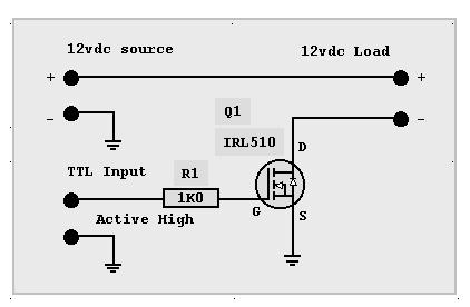

If you're asking how to drive the bulbs directly from TTL then perhaps a circuit like this would work, though the IRL510 is "overkill" for your 12v 1a load...

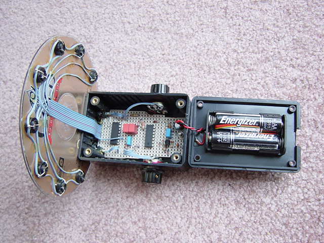

Incandescent light bulbs waste a lot of power by making heat. Because they must get hot to produce light, they need a certain amount of time to heat-up so you can't blink each one for a very short time.
LEDs can make light instantly and are very efficient. Try my "6V Ultra-bright LED Chaser" project:
https://www.electronics-lab.com/projects/games/004/index.html
The LEDs light for only 15ms each and chase around in a circle for a few times around, then pause. It uses modern 74HC Cmos ICs that still work fine when the 6V battery has discharged to 4V. Since the LEDs are only briefly lighted and Cmos uses almost no current then the battery lasts for a very long time. The project has a chasing speed control and uses pulse-width-modulation for its brightness control. :lol:

Mike, K8LH gave you a circuit to drive the lamps in his post above.
